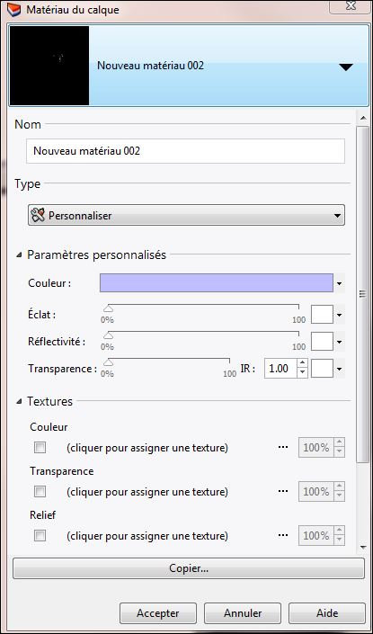

in my rhino 6, why the thumbnails in “material of the layer” window is dark, as if the projector was off, it lights up when changing the setting of the material, but becomes dark again right away.
is it only my rhino?
Can we see a screen capture or something? What is your current renderer?
And the current renderer? Flamingo?
rhino render

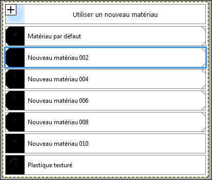

Ok. Open the libraries panel. Do you see the material library?
material library?
this?:
I’ve got it repeated on the French version - thanks! I will have this fixed ASAP!
https://mcneel.myjetbrains.com/youtrack/issue/RH-43212
