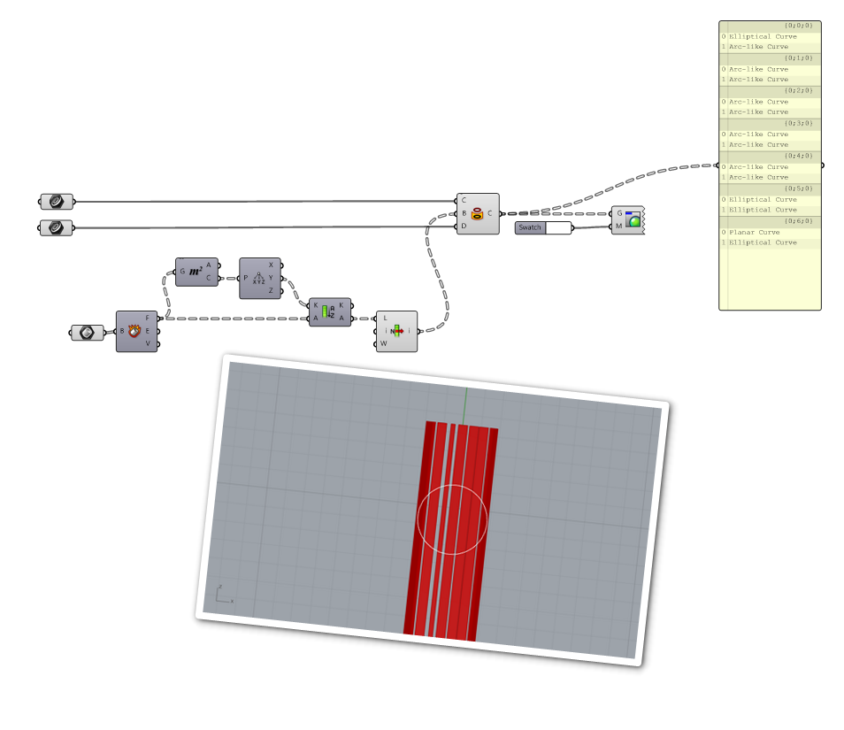

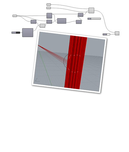

I am looking to project lines on to surfaces perpendicular to the camera. The issue I have come across is regarding the projection, the curve that is to be projected on to the surface raps around the entire brep? In reality, all I need is for it to project on to what the camera sees not everything it touches and the reset. I have looked in to lists and selecting the faces I want it to use, It worked but not too well, once there is more complicated geometry. Once the lines are projected is there a way of filling them in to change the colour? Any ideas?

This is what I was trying to refer to when I mentioned lists. Yes, it does work, but only for very simple setups but what happens when you have complicated geometry, see image attached. This method would mean that you would manually have to select faces through lists and this seam somewhat conflicting as some faces in the list may not be relevant to that section.

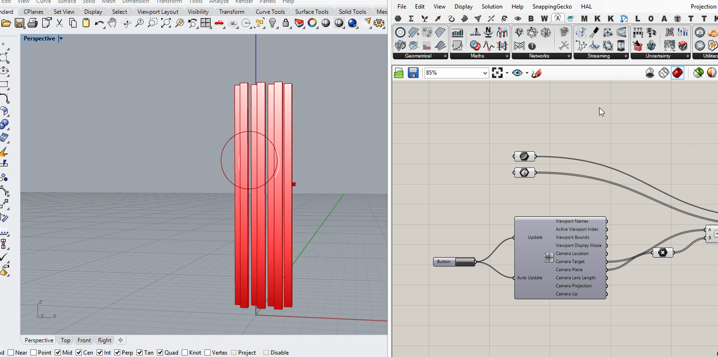

2- set a button (Or even a timer which can automatically reset the vector) and update the camera projection vector as you turn the camera. It works well.

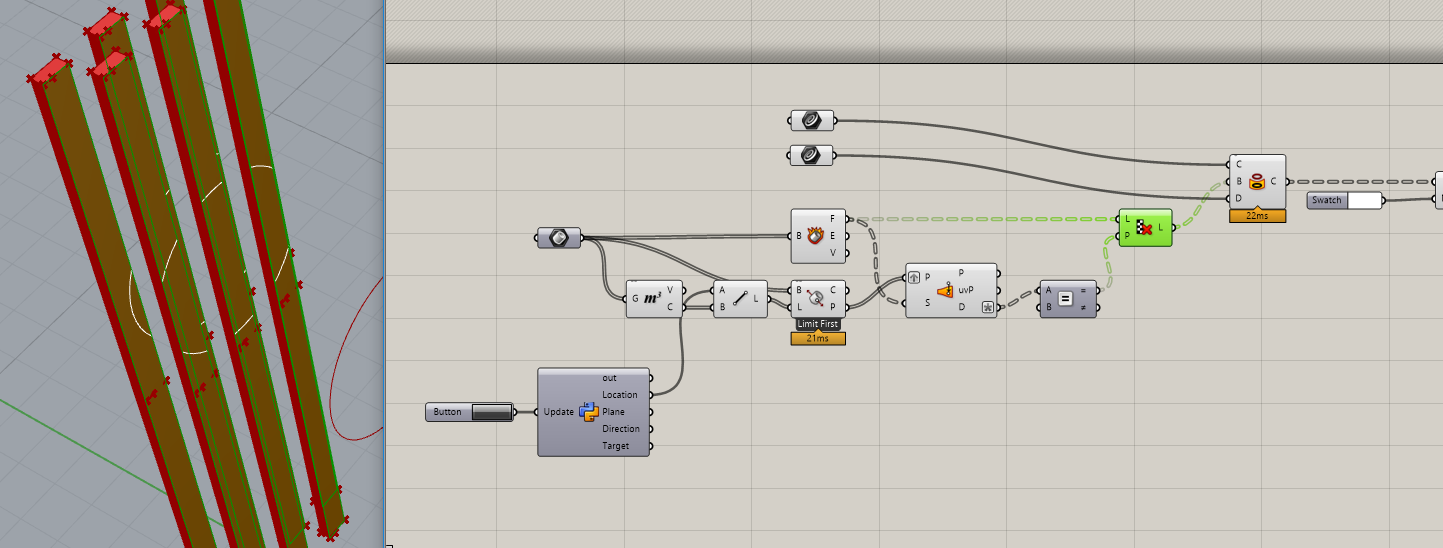

Try with idea of @mahanmotamedi1991 , you can get camera informations with python than intersect lines from camera locations and breps centers to extract faces where the curve must projected.

Projection GHC3.gh (23.4 KB)

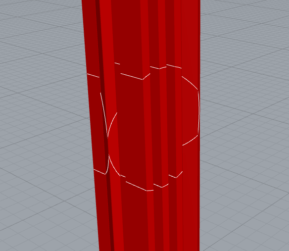

At the moment the lines hit the first face, but if we look at it through the viewport it should realistically project on to multiple faces. Some columns are turned and therefore show 2 faces in relation to the selected viewport (refer to the third image), but only one of their face is reflected on. I have tried to alter the GH Code for it to select all faces visible in relation to the viewport but it does not work well.

The lines intersect with the faces you see in the view.
If you want select some faces you need to do that manually. And if you have two faces , how Grasshopper know which one you need?

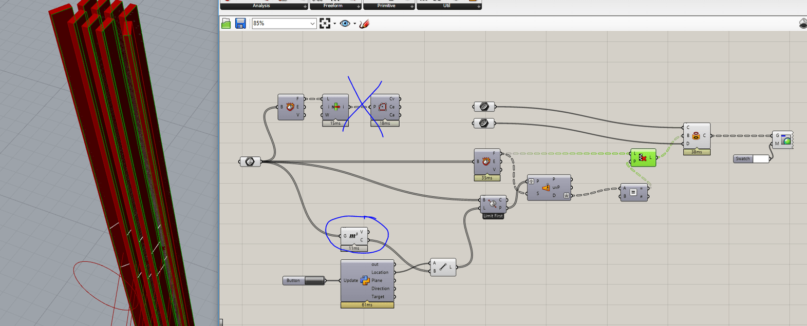

Why you change this?
If you already choose faces you don’t need the script, and when you choose a view you need click update
Try this
Create lines from the centers using negative vector of camera than choose the faces intersect with this lines
