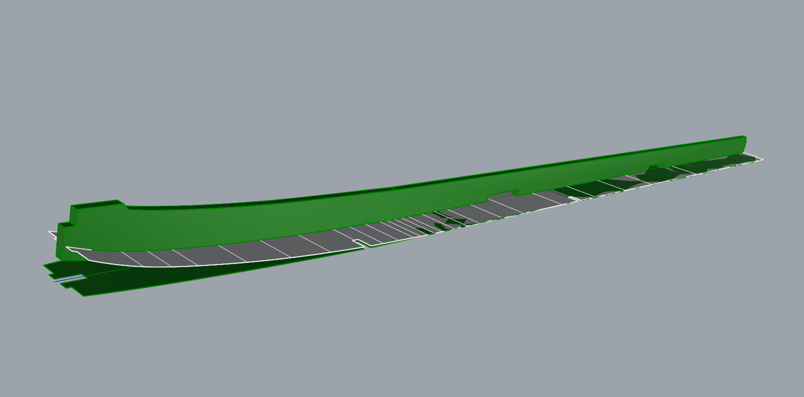

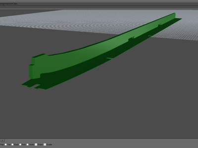

Playing with some virtual modeling and I’m trying to match a flat surface to an extrusion with a slight curve at the front tip. I know it’s possible, I’m just not sure which command and steps to take. Any help would be greatly appreciated! file attached.
matchsrf.3dm (65.6 KB)
Is this what you want?
matchsrf_DC01.3dm (2.1 MB)
I created a curve with the shape of the desired centerline.
Measured the length of the curve. Created a straight line with the exact same length along the centerline of the flat surface.
Flow command
