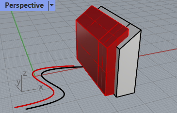

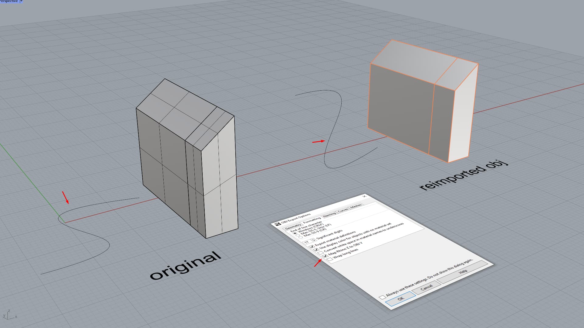

I noticed that Map Rhino Z to OBJ Y doesn’t work as it should with curves.
Rhino 8.0.22095.9345
export curve to obj.3dm (311.5 KB)
Hi Jakub -
I’m not seeing that here with your file:
Red is original, and black is imported and slightly moved…
Perhaps I need more detailed instructions on how to reproduce that issue?
Please check this video.
