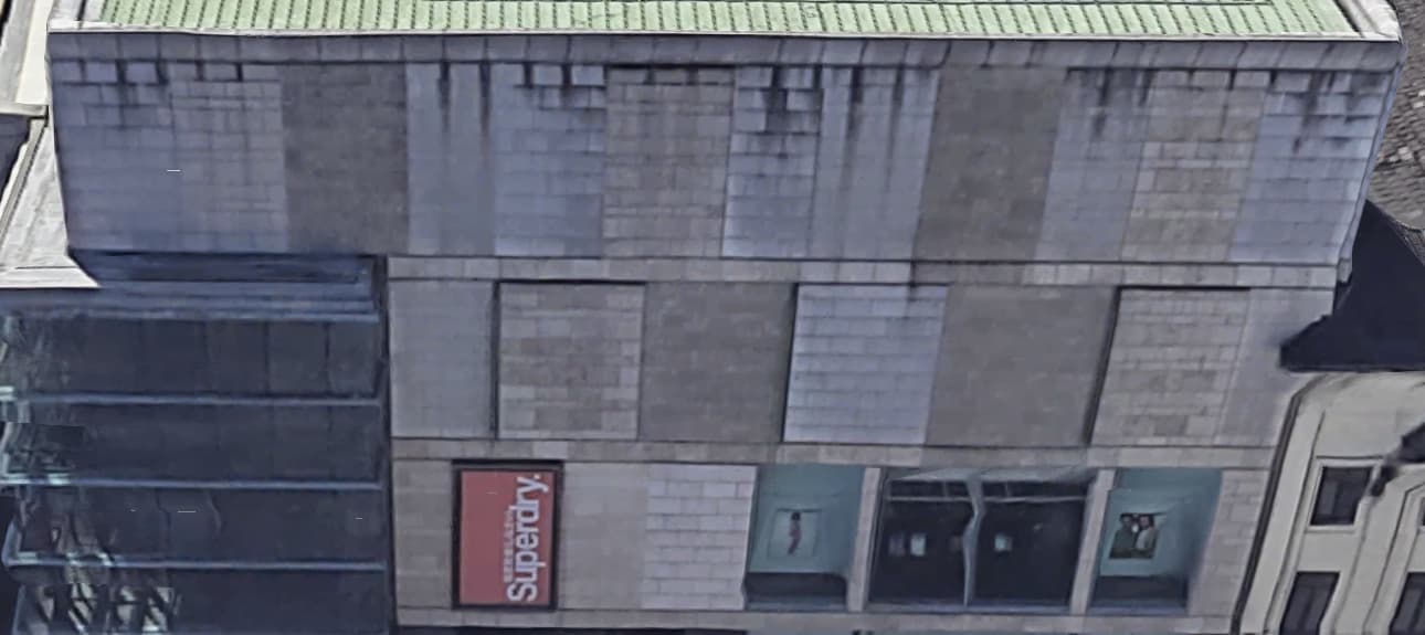

Making a facade but not all the bricks
Is there a way of modeling this facade without doing all the bricks? Maybe just some kind of texture or something else abstract?
What I am doing right now is the whole facade in one piece and the surfaces are just “smooth”.
I am looking for the easiest solution right now, it doesnt have to be perfect.

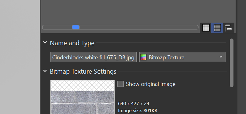

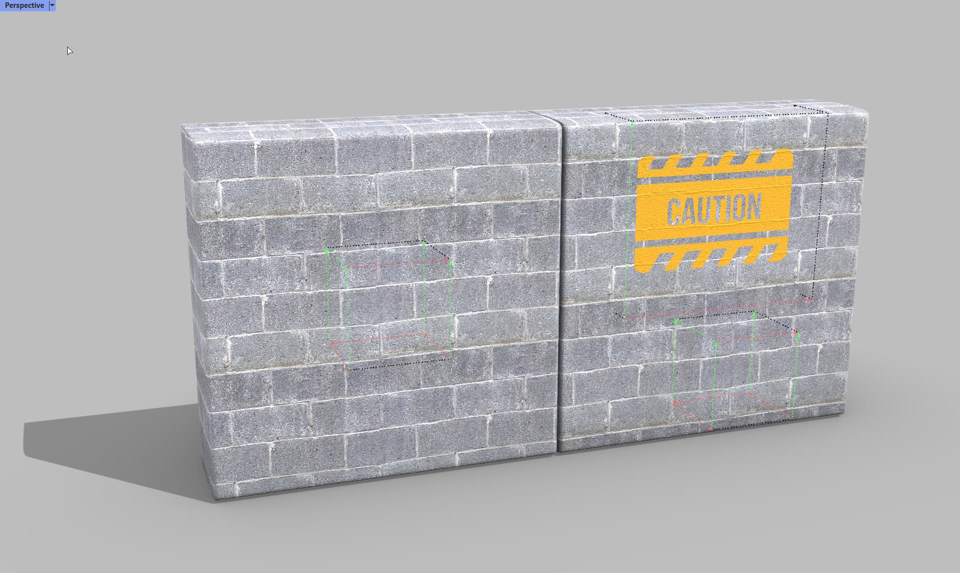

Once you create a cube/wall shape or a subD object, go to the libraries tab and select a masonry block texture from the architectural materials (there are also bricks and other stone/types) then map it to your cube or wall structure. Use decals to do the lettering parts.
I attached a file containing a simple subd object with a texture mapped to it and a decal applied to demonstrate. I left the mapping widgets visible to aid in how you can adjust the texture mapping.

Thank you for your help. I think this could be the solution, but I have not yet been able to make it work. I can not find the bitmap structure as you have shown in your file.
Would you be able to specify more exactly where you find your bitmap texture?
sorry for the late reply, I´ve been on holiday.

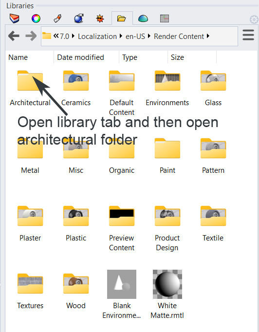

Hi @Hobnob
Open your library tab and navigate to
  1. architectural folder
  2. then to “Cmu folder”
  3. Then to “wall folder”.
    See attached images shows primary folder and then the wall folder.
