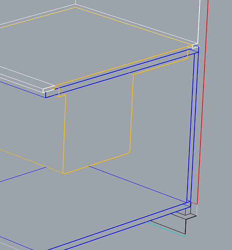

Ok, but in yours, the ‘inner’ edges appear to be on the ‘hidden’ layer, like if the clipped surface was filled (like cutting a real solid):
This is also the behaviour I’m looking for.
In my model, the inner edges are treated as ‘visible’ (like cutting a hull):
I get the same output with your file:
Edges viewed through the clipping plane are considered as visible.

Humm, not sure it has to deal with linetype, please see here, the selectionned segment is really on the ‘visible’ parent layer:

I increased the LT scale and I now see dashed lines. Unfortunately it was not my problem. I think there’s misunderstanding in the air :slight_smile:
1 - what I get out of Make2D: inner edges are on the ‘Visible::*’ layers
2 - what I want: all inners edges occulted by the clipping plane to be on the hidden layers:
If you uncheck the Hidden lines option in Make 2D, the the visible surfaces will occlude the surface edges and curves behind them.
3 - the result with unchecked ‘hidden lines’ by Make2D, still hollow representation:
It looks like your Clipping Plane is slicing off the front face of the box in 1 and 3 so you can see the insides.
2 looks wrong to me.
But 2 is exactly what you get in your example:
I had my Perspective view rotated around so the clipped off surface is on the back, away from the current view.
OK, that’s an explanation. So I understand that the original wish of this thread (capped solids while performing Make2D sliced by a clipping plane) have not been implemented yet.
