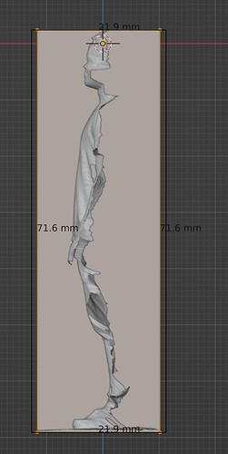

Your PLY file has the object about 71.6 units high, I believe them to be millimeters.
Imported into Blender the object stands 71.6 units high. Imported in Rhino 7 into a millimeter template with meters selected on import the object is 71.6 millimeters high - corresponding to the 71.6 units of Blender.
(blender rounds off number in display, it is 71.55)
Well, if it’s supposed to be a life-sized human, then inches would be correct - 72" = 6 feet or about 182 cm.
That’s correct he is that tall… but it issue still remains that PLY imports in inches aren’t working the same as the windows version.

Something is going on with the scale on macOS, yes.
I’ve filed this as RH-73477 File IO: PLY import scaled incorrectly on macOS
I see that behavior here on Rhino 7 on macOS. This appears to have been fixed in Rhino 8 somewhere along the road.
