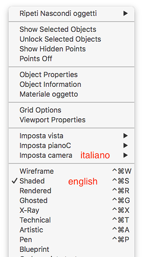

Yesterday I updated sisema operating in Sierra (Italian). I encountered one difficulty and a problem. The difficulty is that the menus are mixed in English and Italian. The problem however is that so completely random, after selecting a simple command, appears the colored ball spinning for a few seconds and only then appears on command.

Not sure about the slowdowns. As for the localization (translation) problem, please let us know what your Rhinoceros > Preferences > Language setting is. I’d wager that it’s “Use macOS language setting.” If so, please set it to Italian explicitly. We have a bug on our list related to this issue.

Great. Setting the language explicitly the problem seems solved.
As for delays, decreased by deactivating the option to System Preferences> Power> put in stop the hard disks when you can.
