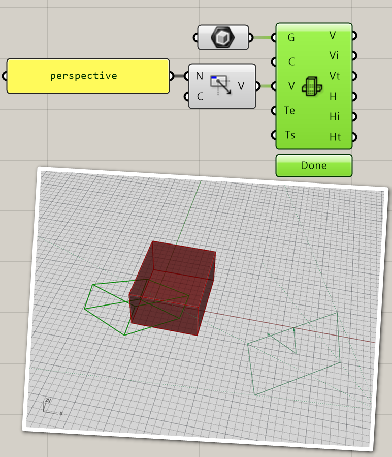

I think this tool should make a perspective immage on the grid, but I obtain a parallel immage, so I think It doesn’t work well, Does It?
I can’t make it work either right now. You’ll have to set up your projection as a Rhino viewport or Rhino named view, then import it. I’ll look into why it isn’t working.
