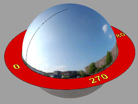

Sure, that would be fine. A text dot at the insertion point would be fine but it would require to delete it every time a new rotation is applied … nevermind, maybe its easier just to show it in the command line.
All this exercise is because I work with vray and when I use a dome light with an hdri for the background, it’s a p.i.t.a. to get oriented trying to place the sun or any light source of the hdri in the right location to get the shadows where I want them because vray for Rhino doesn’t show the environment hdri in the viewport. What I use now is a sphere with the same hdri that I’m using for the background & dome light and I can visualize where the light is. To get even more confusing, vray spherical UVWGeneEnvironmet mapping tipe puts the Rotation zero in a very counterintuitive place (9 o’clock) and rotation angles increasing clockwise …
If I make the sphere a block and I can see the angle as I rotate, I could quickly see what angle I need to enter in the vray mappings. Even better if the rotation direction and zero degrees origin match the ones used in vray.
