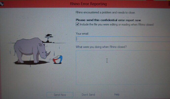

Starting the program offline on my laptop:
Rhino starts,shows the toolbar, than I get the error:’’…Rhino is not working correctly…because of a Problem the program is not rightly executed…close the program , inform us about the problem by email.’’
Starting the program online on my laptop:
‘‘You won’t keep the Lizenz on this computer ?’’
Yes. Zoo is starting.

So, here you are the screenshots.
1.Starting the Laptop online .Find the License
2.Rhino shows the toolbar
3.Error
4.send email

Hi Barbara - that means that either a plug-in that is being blocked in safe mode is causing problems in normal mode, or, and I suspect this is the case here, there’s a problem with OpenGL, which is blocked in Safe Mode. Can you please run the command ‘SystemInfo’ in Rhino and paste the results here?

Hard to run much these days with that little RAM. 8 Gb is recommended for V6 (also for V5).
I’m wondering if you’re not running into out-of-memory problems.

With Rhino 6 unlikely… I am surprised Rhino 5 ran on it OK…
