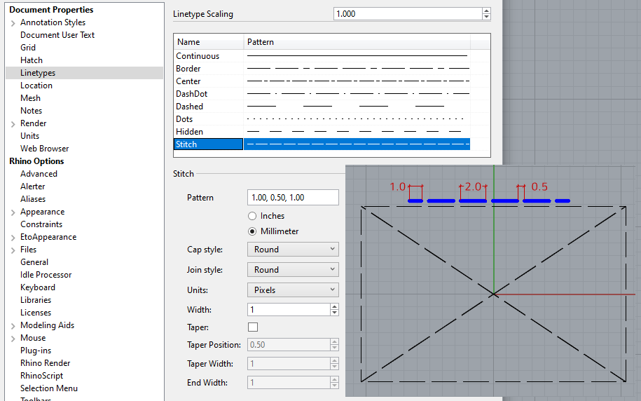

In a file units inches decimal, I decide to create a Linetype call it Stitch01 and its 0.1 0.05 0.1

It’s not necessarily wrong to have 3 values here but you need to understand that this is “ON OFF ON” → which will lead to 0.2 shown and 0.05 as gap.
If you are referring to PrintDisplay -> LayoutLinetypes, that is gone in Rhino 8.
In a layout, the page size is taken into account and lengths will be accordingly.
This is the same scene as seen from a detail on an A5 piece of paper:
In the print options, switching between “Match pattern definition” and “Match viewport display” might help?
