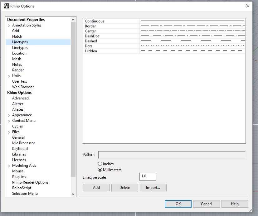

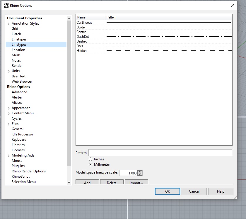

Linetypes duplicated in settings
As in topic. V 6.6.18156.11421

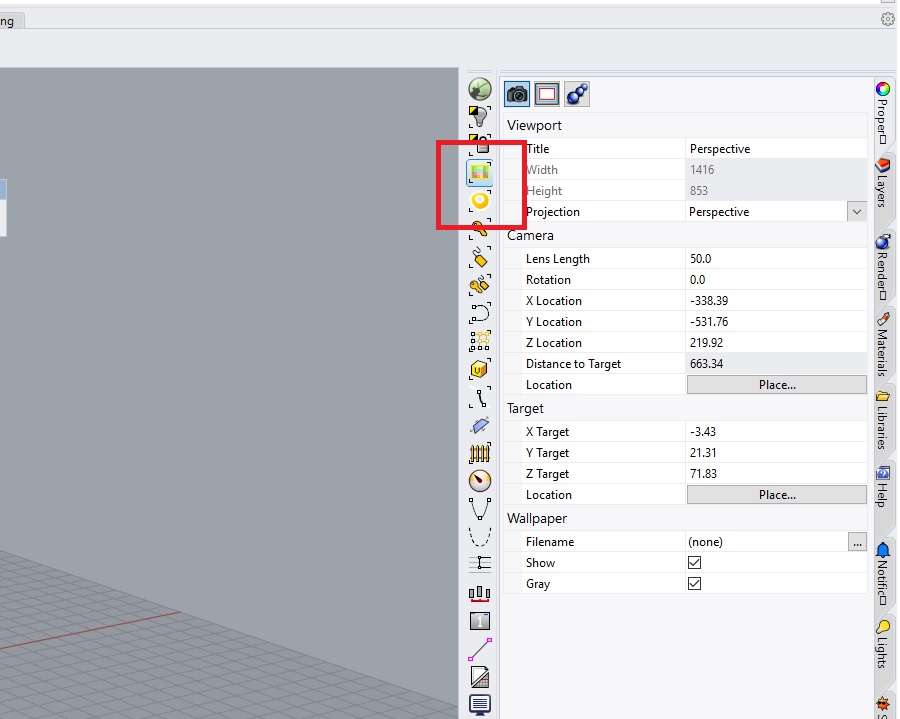

Oh and btw. there is bug in toolbars when are set in vertical - buttons are trimmed…
Hello - yeah… the extra linetypes entry should go away with the next update. I’ll see if I can make the buttons do what you show. Thanks for the report.

I have two linetypes listed here in (6.6.18156.11421, 05-06-18)
In the first one I am actually able to change the linetype scale, in the second, although the box lets me type or scroll a value, nothing happens and it always goes back to 1.0…

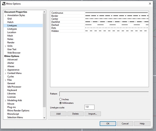

@pascal @JohnM @dale in (6.6.18163.7531, 12.06.2018) linetypes are set once but i still have no luck with my custom page - could you check this with v5 compatibility?

Btw. @pascal in newest ver buttons are still trimmed in vertical docked bars
