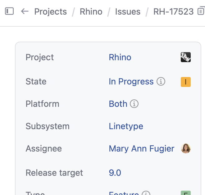

Is this on the table for Rhino 9?? Would love this as a feature!
Hi Isabella -
RH-17523 is visible to the public and you can always check for activity, status, and target. As of now, this is on the list of things to implement in Rhino 9 before its release:
