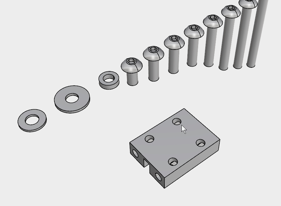

I’m developing a plugin and I want to allow user to click on a hole feature on a closed Brep model. I want to can get the Circular Curve that he clicked and the Normal direction of that hole. So that I can programmatically place a screw in it.
Anyone know if there is a trick to do this with RhinoCommon functionalities.
Better if the user see highlighted border as a visual cue during the picking.
Thanks.
I would probably start with the GetEdgeCurves method if you want the user to pick the edge of the holes.
After you get the curve you should probably make a reference to where to pick the screw. Maybe a point you have added to your screw? Then you can move the screw from that point to the center of the EdgeCrv.
Hi Victor,
To pick a “hole”, you will probably want to create an instance of a GetObject class and set the geometry filter to BrepLoop. Here is an example that may help you:
