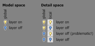

What makes no sense though is this thread’s topic - why must changes in model space layer visibility carry over to all Details?
I tried to convey a few debatable solutions, but was unsuccessful in starting a debate about them:
  1. Add a second layer toggle (lightbulb) in model space, which is local to model space. When you work there, the local toggle can be used to filter the viewports. All details AND model space would then have 2 layer visibility toggles. The first toggle would remain global, which can be useful.
  2. or, remove the first (global) layer visibility toggle in the Details, so there are only local toggles anywhere. Simple.
  3. or, just add a Detail checkbox property to override all global (model space) toggles with ‘on’.
    Worth a thought?
Agree.
A simpler tale for .1 &.3 would be the possibility to alt-click lightbulbs creating a special “locked lightbulb” with its unique icon (could be a red border or gray background) to indicate an override. That would make extra columns & checkboxes unnecessary.
Thought about that. These graphics show the layer toggle logic:
Status quo:
Your proposal, with an override in Detail/Layout space:
My proposal no. 1, where in Model space you would only toggle the local lightbulbs, and leave the global column in peace, except you absolutely need to turn off this layer everywhere:
Might be a matter of taste which way to go.
