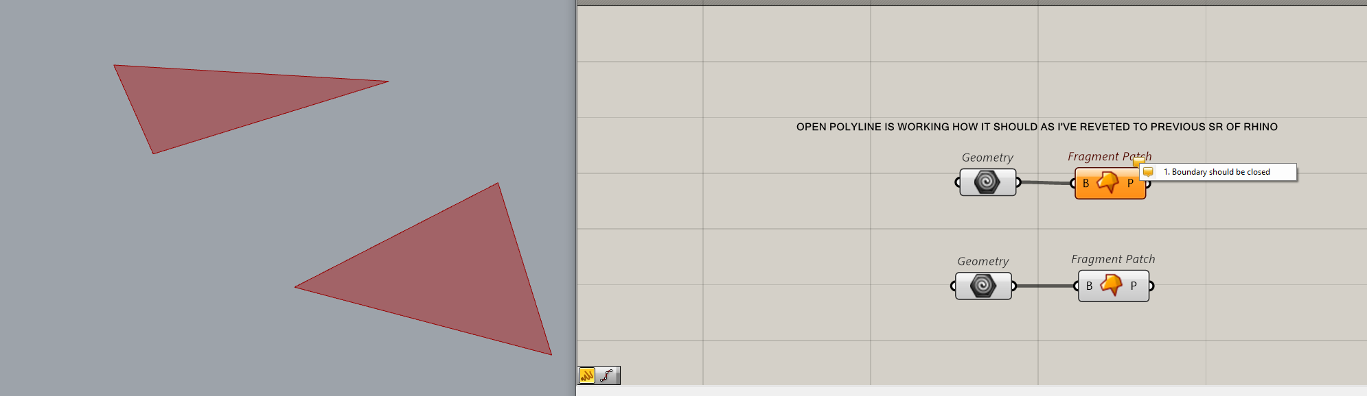

Yesterday I updated to Rhino 7.32.23191.11001,2023-07-10
It’s stopped the FPatch in Grasshopper working as it always has which is an issue as all my definitions use it.
Previously if an open polyline was drawn EG: V shape. FPatch would still patch it with the orange warning on the box ‘Boundary should be closed’. Most likely unintentionally, but very useful.
Now it goes red and won’t patch.
My colleague hasn’t updated Rhino yet and his still works.

Not seeing an issue, can you post the geometry that is failing? I’ll try to replicate. Thanks
The example attached is working again on mine as I reinstalled to the previous SR, but this should show it not patching on the present SR.
FPATCH.gh (7.7 KB)
The Boundary should be closed.

for what is worth, Version 7 SR32 (7.32.23191.11001, 2023-07-10)
Ah yes! That’s the exact issue I had!
Thanks for reporting and getting this repeatable so quick. A lot easier to track down the change now than in a few weeks or months.
I’ve just tried to update again and the same problem occured, so I’ve reverted to the previous version which works and turned off Enable Updates.
