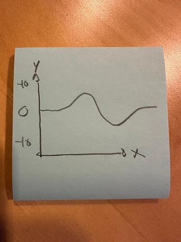

Thank you Joseph for your aswer. The idea was that Lamellas would rotate according to curve function according to Y-value and X-axis the lenght of the curve.
. Below simple drawing.
Apparently we have a language problem because that still makes no sense to me?

Wild stab in the dark at interpreting your objective as depicted in your “simple drawing”:
Lamellas_2025May5b.gh (19.1 KB)
I’m sure it’s wrong. @inno, your mind reading skills might help here?

Yes, there are many ways to do this. Unfortunately, I’m not confident that we ever understood what you actually wanted and tried to describe with your “simple drawing” and “curve function according to Y-value and X-axis”. That’s a problem.
Also, it would be difficult to build when angles always change, as in the code we posted. I imagine it would require a list of 200 angles relative to the curve tangent at each point.
