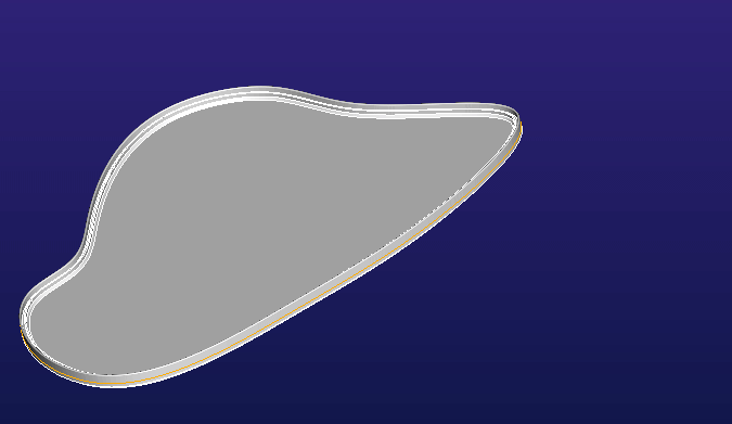

Another thing that I miss from other cad tools is the ability to measure from a face to a face (two parallel faces). Is there a tool in Rhino I’m missing or is this just not possible without a bunch of extra steps again?
How to do this in Rhino?
xtop_yRvO6vW6uY
shape.stp (402.2 KB)
Look for “Closest points between objects” in the first post in this topic:
ClosestPt2Objects.py (3.7 KB)
Also, in post #15 there is a plug-in called “byRhinoGadget”, which contains a few similar tools, such like “Distance between 2 faces”, “Distance pt between 2 objects”, “Farthest 2 points in a curve”, “Min Max distance from 2 curves”…

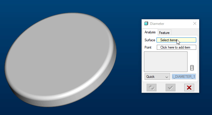

Another example where measuring in 3d fails: Diameter / radius:
What I expect:
xtop_Nvcnl9mOB0
Rhino:
Rhino_CipscmVyJC

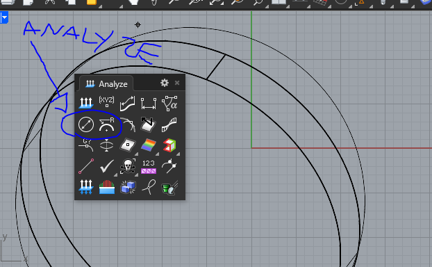

This is something that was requested so many times during the years… I lost hope that it will be fixed a long time ago.
You can make a macro to temporarily build a CPlane along the circle, then add the radius/diameter dimension, then revert to the previous CPlane.
! _CPlane _Object _Multipause _DimDiameter _Pause _CPlane _Undo
! _CPlane _Object _Multipause _DimRadius _Pause _CPlane _Undo

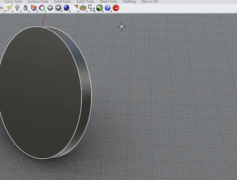

PLEASE HELP
! _CPlane _Object _Multipause _DimAligned _Pause _CPlane _Undo _Multipause '_CPlane _World _Back
You have to pick a planar face to align the temporary CPlane first.
Do you use Rhino 8 with AutoCplane enabled? Looks like something is wrong with the CPlane alignment by the end of your video.
Thank you, I’ll give it a try.
I’ve tried it, but it still didn’t work.
