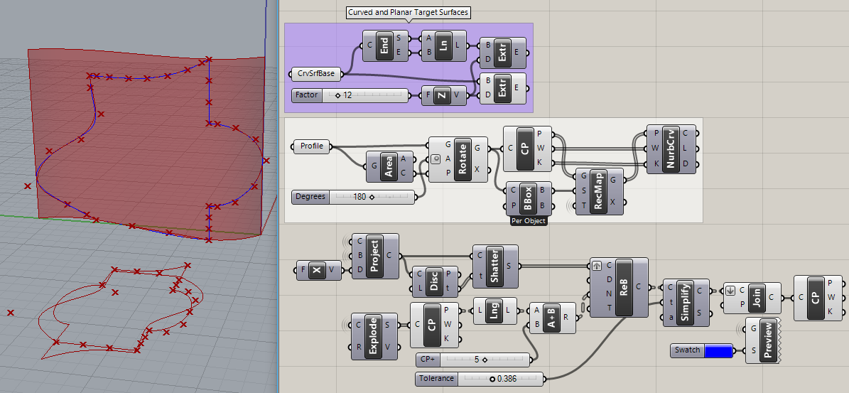

mapsurface_2018Jan29a.gh (25.5 KB)

this only works for planar profiles. The moment you crown the profile top surfaces and you look not from top view you may notice a weird flow.
So that is why I said, straight or jagged . If you create a polyline and not a curve at the intersection points this problem will disappear. However if you assume staying planar and you are not crowning the surfaces in z direction you won’t have that problem and you can use a curve.
This however is a very special case and won’t count for nonplanar profiles. I may code this case up, later the day since this case is rather simple.
