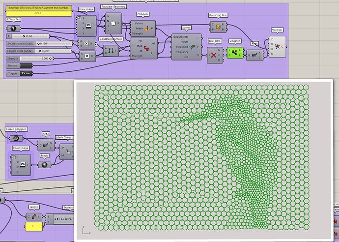

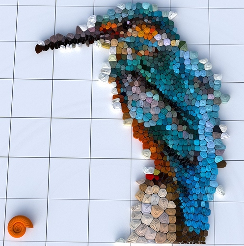

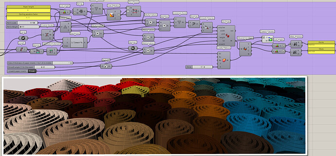

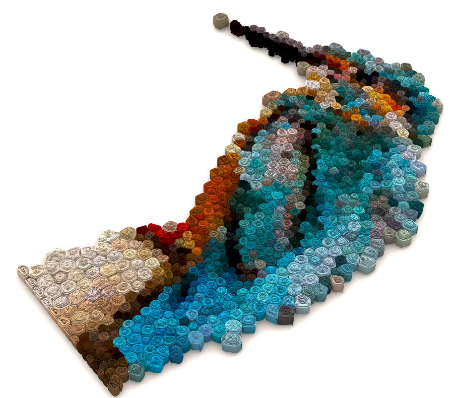

Here a rendered of 3d geometry replicating work from Entagma “PROCEDURAL MODELING: QUILLING 06.11.2017 by Moritz”
[http://www.entagma.com](http://www.entagma.com)
- Primary image of Kingfisher from
[https://pixabay.com/p-2046453/?no\_redirect](https://pixabay.com/p-2046453/?no_redirect)

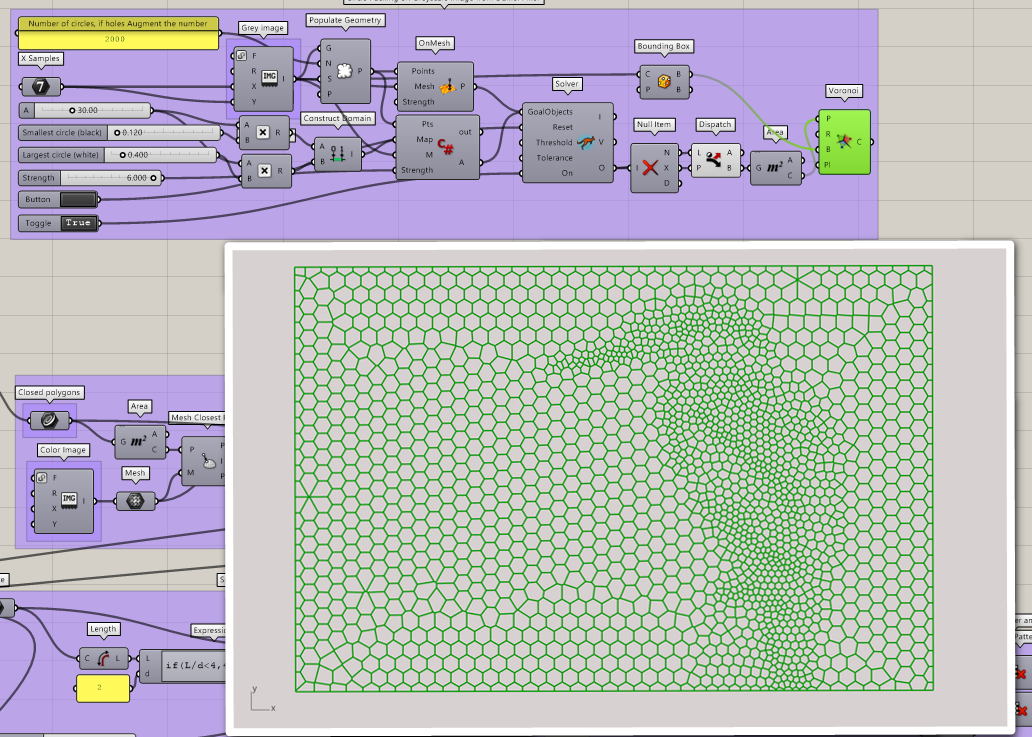

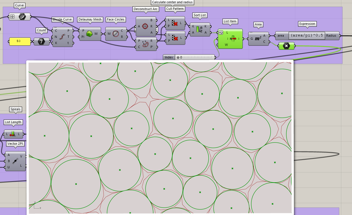

- Points for Voronoi diagram are generated using Kangaroo Circle Packing based on Image from Daniel Piker
- Voronoi cells are then smoothened and spiral are done like in Houdini Video
- Paper is thickened via a script I did in order to go fast, it thicken a polyline and extrude it to a mesh.
- Render in Rhino 6 via Cycle using Grasshopper to color mesh
Here is the script.

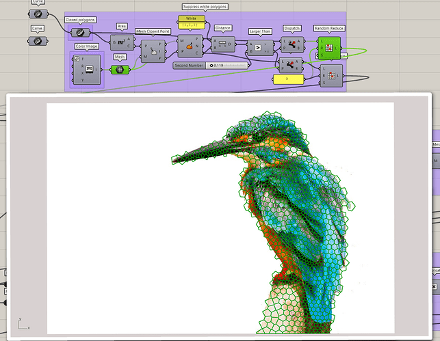

1. First find an image. Here the kingfisher is from [https://pixabay.com/p-2046453/?no\_redirect](https://pixabay.com/p-2046453/?no_redirect)
In order to generate the intended circle packing the image is transformed in grey scale. Play with contrast luminosity … For example I used this one and also another.
2. Now use the color image in order to suppress polygon which have a color near the white. Beware when color is transformed to a point in GH it ranges goes from -1 to 1, not 0 to 254.

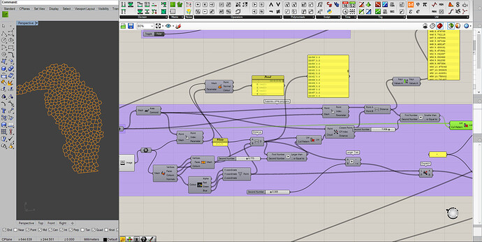

 ![Canvas at 13;34;56](https://global.discourse-cdn.com/mcneel/original/3X/d/9/d902eca356cdcb7ad075ea2dc0b7a0e3fbfe9794.png)

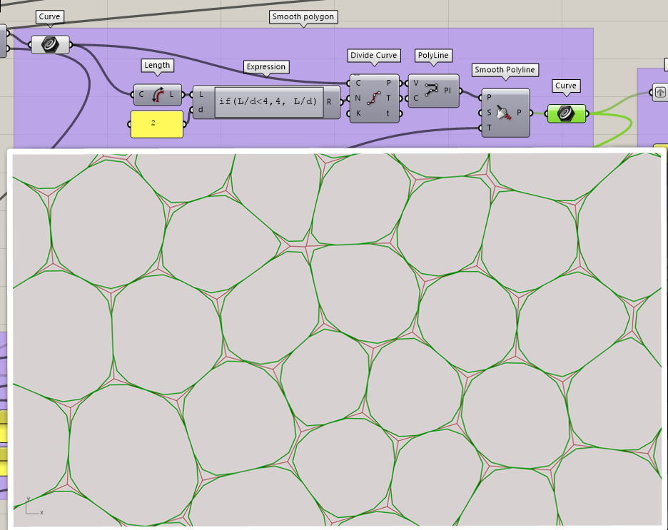

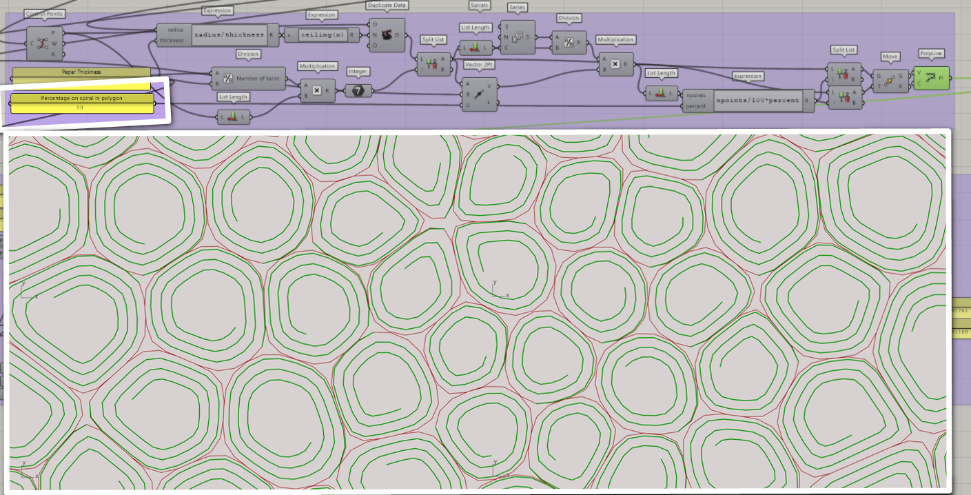

1. The polygons are then smothened
2. The max circle inscribed in rectangle is searched, it outputs the radius and the center.

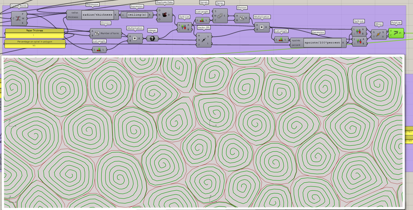

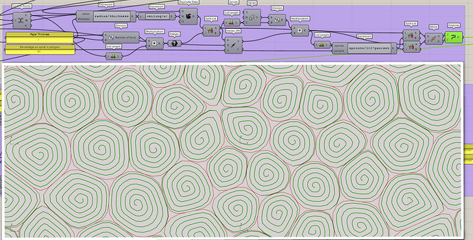

3. Spirals are now made, you can choose the paper thickness and the percentage in length you want for the spiral.

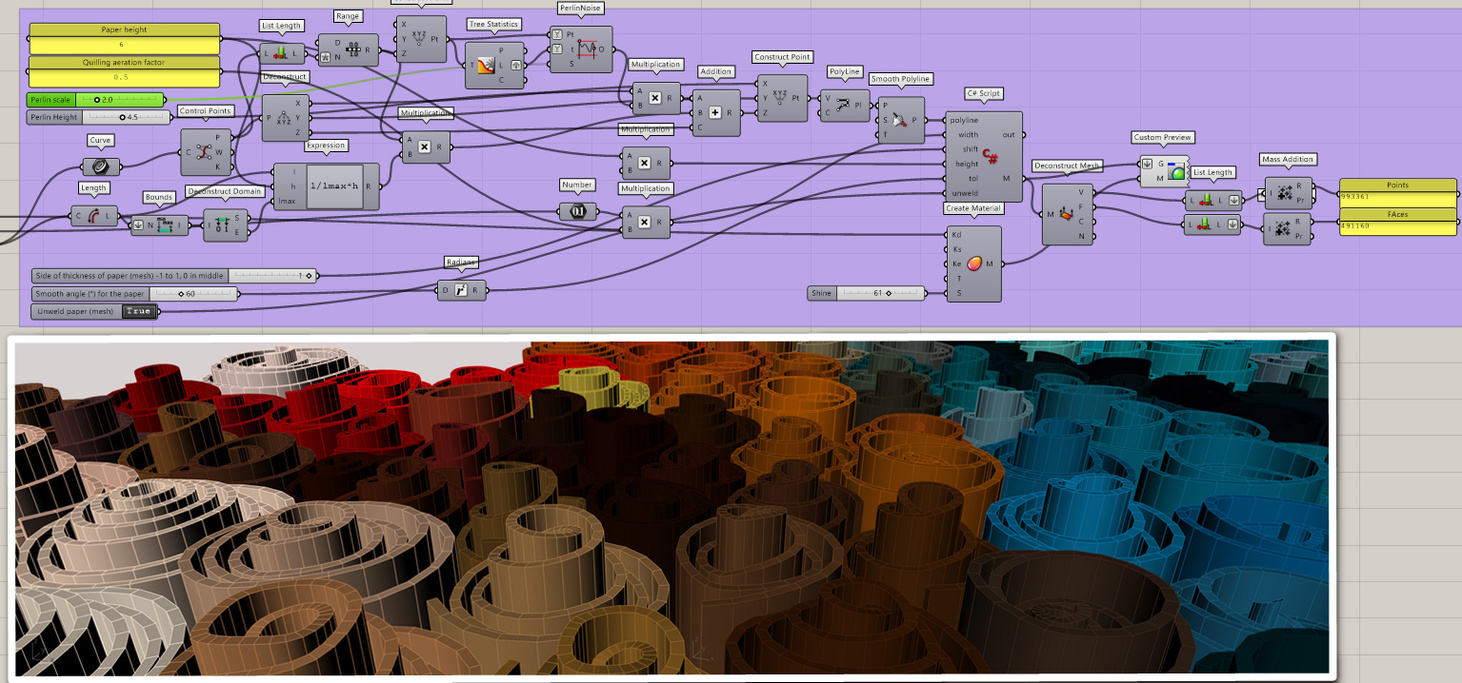

4. Spiral are then thickened via a script I made in order to limit the number of faces and fasten the script. Offset, loft curves are too slow and too heavy ☹ You can make paper thinner. You can play with Perlin noise parameters, see examples below with low noise, no noise, low scale and high noise.

Render view with -ViewCaptureToClipboard is also good and very fast. Here 2000 passes with 2 types of paper thickness.
 ![quiling3](https://global.discourse-cdn.com/mcneel/uploads/default/original/3X/a/0/a01b3d15bb8b1950e45c6594157118da655b0945.jpg)
 ![quiling4](https://global.discourse-cdn.com/mcneel/uploads/default/original/3X/1/8/1860256bd3933947c6e14fb977bd101bef4b0aad.jpg)

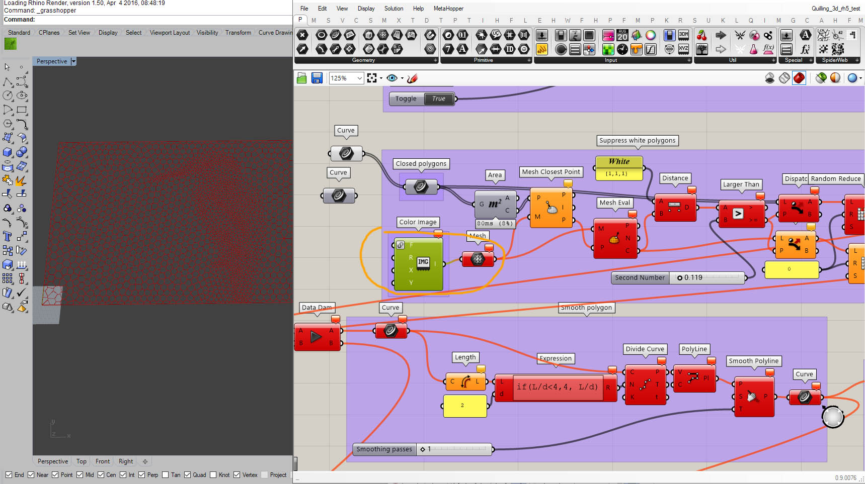

Hi @laurent_delrieu Thanks for sharing. I am trying to work with it on rh5.
 ![1](https://global.discourse-cdn.com/mcneel/uploads/default/original/3X/1/a/1a9eedd289a254d9eb1d926a55427dc70a2024d4.jpeg)
but the import image component that converts color image to meshes causes the whole program collapsing, once which the image path has been synchronized. I wonder if this causes by the limitation of rh5, or I need to do some settings with the import image component.
[Quilling\_3d\_rh5\_test.gh](https://global.discourse-cdn.com/mcneel/uploads/default/original/3X/5/f/5f6d6b95ae852c0332ad0c8a6d3a42776b478f5d.gh) (817.4 KB)

By default this component is making a mesh with a number of vertices same as the number of pixels. So if you input a big image it could lead to big mesh. Put Xand y at 200 or 300 for example.

Hi @laurent_delrieu Thanks for your reply. It seem more likely the crash coming from the Mesh Eval component. Is there any other way the similar thing by using different component?
[Quilling\_3d\_rh5\_test1.gh](https://global.discourse-cdn.com/mcneel/uploads/default/original/3X/c/7/c7dff858077a34afd44dd214fe063b7a0146ab2c.gh) (1.0 MB)

There was a bug with mesh eval when there are no normals on mesh. So you have put normals on mesh.
I thought this was updated. Do you have the last version ?

Hi @laurent_delrieu Thanks for your suggestion. The Mesh Eval basically works now by adding deconstructing and constructing mesh component before it. But how to separate the spirals inside the Kingfisher.
 ![2](https://global.discourse-cdn.com/mcneel/uploads/default/original/3X/6/5/65484181a4d194e3c7c845896606a2e73e31a7ce.jpeg)
[Quilling\_3d\_rh5\_test1.gh](https://global.discourse-cdn.com/mcneel/uploads/default/original/3X/4/7/47a9145de47d2f0ac910404968818ee67e4b2b21.gh) (998.9 KB)

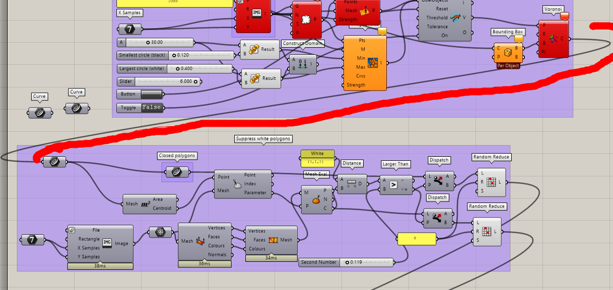

Hello
The suppress “Suppress white polygons” is doing that but you must put an image with white parts. You will see {1,1,1} it is the white in 3d space. Grasshopper converts color to {-1,-1,-1} {1,1,1} cube. So I just filter colors by distance here.
You must link your Voronoi to the curve input
 ![image](https://global.discourse-cdn.com/mcneel/uploads/default/original/3X/f/a/fa70bd74c59d3401d02a2f2bc4e0d49fe6f2a003.png)
Depending on you color of backgroung, you will have to play with the color (not white here but grey) and distance
 ![image](https://global.discourse-cdn.com/mcneel/uploads/default/original/3X/5/9/59951937c259e5b2b61dd79bf1dfdf85dc4678f8.png)
It still works,
 ![image](https://global.discourse-cdn.com/mcneel/uploads/default/original/3X/9/c/9c7fc4b1711464ac87a6f6ccbc46c40be6055ff2.jpeg)
You have to learn how to navigate in a definition and look what is working or not, if all geometry is at the good place …
Use that
 ![image](https://global.discourse-cdn.com/mcneel/uploads/default/original/3X/f/c/fc3114bb7743887f860ad94c97cac59f1ce10111.png)

In order to palliate the mesh eval bug in Rh5, you could use that to have a color on a mesh.
 ![image](https://global.discourse-cdn.com/mcneel/uploads/default/original/3X/8/4/8427be4dfe7cf37e3a1d8c5fd3c1de5d6c9d32e1.png)
The trick is to use the index of closest point, index is used to access the mesh vertex color.
[color on mesh.gh](https://global.discourse-cdn.com/mcneel/uploads/default/original/3X/8/c/8ca06604fce1e4b3a9cf8a6619068e22359304cd.gh) (5.3 KB)
