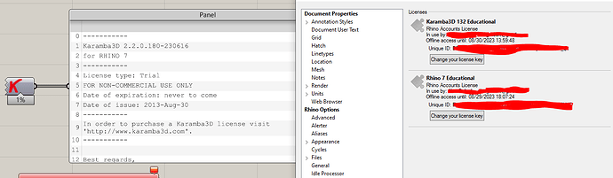

I’m using Revit 2024 with RIR with GH. One of my GH plugins (Karamba3d) has a license req. and this works fine in normal RH7. However, when I open Revit with GH, my license for Karamba3D is somehow removed and deleted?
The only way to get the license to validate again in normal RH7 (Because the license is somehow deleted by opening GH in revit?) is by reinstalling the plug-in. And its never been vailid in Gh or RIR.
PS, The grasshopper plug-in itself works fine on both RH7 and GH-RIR without validation, even in RIR, all functions are there (trial version), its simply the validation of the license is experiencing some weird stuff by completely bricking itself.
Interestingly, when I look at the licenses in RIR and not the GH panel, it says they should be valid.
There has to be a way to get them to work as I’ve seen others use this kind of work flow before.

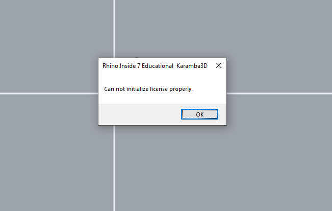

In Revit 2023 I get this message
did you make sure that “karamba3dgetlicense” is enabled? Another workflow would be first to open Rhino standalone, retrieve the license and then open Revit and RIR.
Thanks, works great now!
