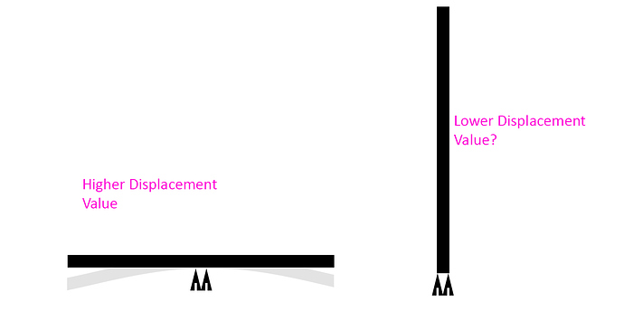

Hi Clemens, thanks for replying - you’ll have to forgive me for a possibly silly question. I’m not very experienced with Karamba yet! But in the image bellow, the example diagram on the left would in theory produce a higher displacement value than the one on the right?
If true then my question is whether it is possible to set up so that the object is treated as rigid and the only thing that matters is the amount of mass each side of the pivot points, thus each object should have an identical ‘displacement/balancing’ value. Hope this makes sense?
Hi MMO, instead of the displacements you could try to minimize the resultant bending moment at the support.
Best,
Clemens
