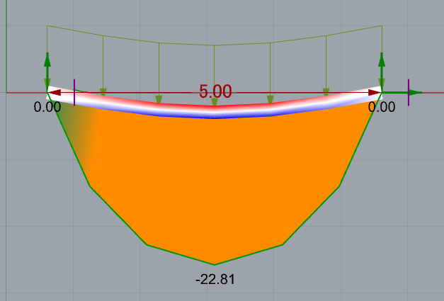

I’m using Karamba’s official sample file.
I checked 「Numbers」 of Beam View component, but numerical value do not show at segement.
Rhinoceros unit:m
Karamba unit:m
Thank to anybody willing to help!

Hi, what do you mean the values do not show at segments?
The values at this point (red circle) do not show.
Is this normal?
I want to see the values at that point as possible.
Hello @kinu,
in the current build of Karamba3D only the minimum and maximum values of a cross section force diagram get annotated with numbers. The reason for this is, that in case of small segments the numbers intersect each other and get unreadable.
A workaround in your case would be to subdivide the beam into multiple segments, so that the numbers get displayed at their endpoints.
– Clemens
I understand.
Thank you for your help.
