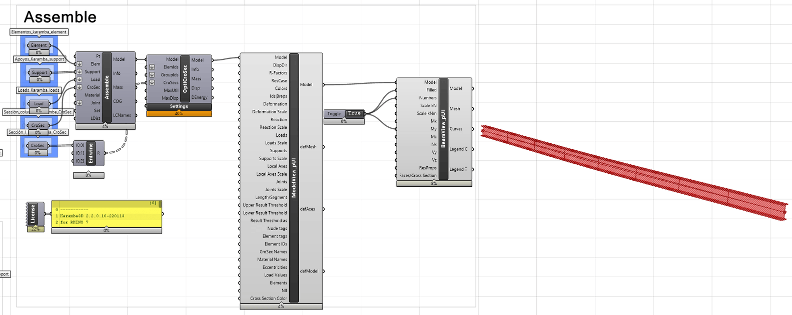

Hi, I have tried differents things to fix the problem or at least to now whats going on.
I found that the Crash when I calculate the model was related to the “UI” components ( I think because when I actualize Karamaba to 2.0.10 this coponents needs to be delete and inserted again) . When I insert new “model view UI” and " beam view UI" components the model dont crash.
The problem now is that these components are not rendering reactions, supports, tags, diagrams …
Image and file of the problem is attached here
ErrorUI_COMPONENTS.gh (39.7 KB)
Wait for your help!
