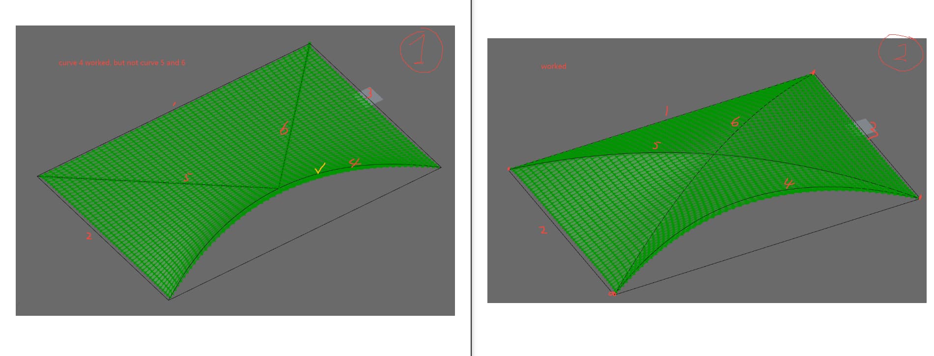

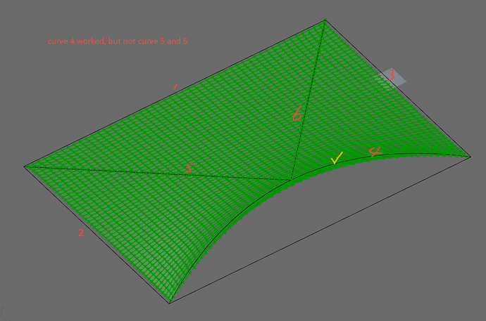

I am trying to simulate a soft film that is anchored by a several lines, but having problems with curve 5 and 6. It works fine when curve 5 and 6 are connect at the vertexes, but it does not work when curve 5 and 6 land in the middle of curve 4. Does anybody know why? Is it because of that the end points of curve 5 and 6 must land on vertices of the big rectangle boundary?

These points have nothing to do with the mesh.
 ![image](https://global.discourse-cdn.com/mcneel/uploads/default/original/4X/d/a/a/daaf8126d1342412ef0d8320df7ef3e4dc5f4b30.png)
<div class="post-metadata">
**Author:** ![Quan\_Li](https://sea3.discourse-cdn.com/mcneel/user_avatar/discourse.mcneel.com/quan_li/32/679256_2.png) [@Quan\_Li](https://discourse.mcneel.com/u/Quan_Li)\
**Post date:** [October 9, 2025, 10:07am UTC](https://discourse.mcneel.com/t/kangaroo-force-not-recognize-curve/210773/5 "2025-10-09T10:07:25Z")
</div>
Let me be more explicit. These red - marked points are not mesh points, while the others are.
How does K2 determine which points are mesh points? It does so by measuring the distance. Specifically, the non - red points are extremely close to the points on the mesh. Therefore, K2 includes them in the simulation. In contrast, the red - marked points are too distant from the mesh vertices.
 ![image](https://global.discourse-cdn.com/mcneel/uploads/default/original/4X/0/c/1/0c1fabd0596c3137653331debc959a31f7880fe9.png)

Thanks for your reply! It makes sense, however, looking at the images below, does that mean that points on curve 5& 6 in image 2 are closer to the mesh, and points on curve 5&6 in image 1 are away from the mesh, determined by K2? Is there a way to adjust the threshold of distance that K2 is calculating? Is there a way to make image 1 work? Should I cull the points on the mesh that are close to curve 5 and 6, and have those points pulled toward curve 5 and 6? (Image at the bottom wit the yellow zone)
