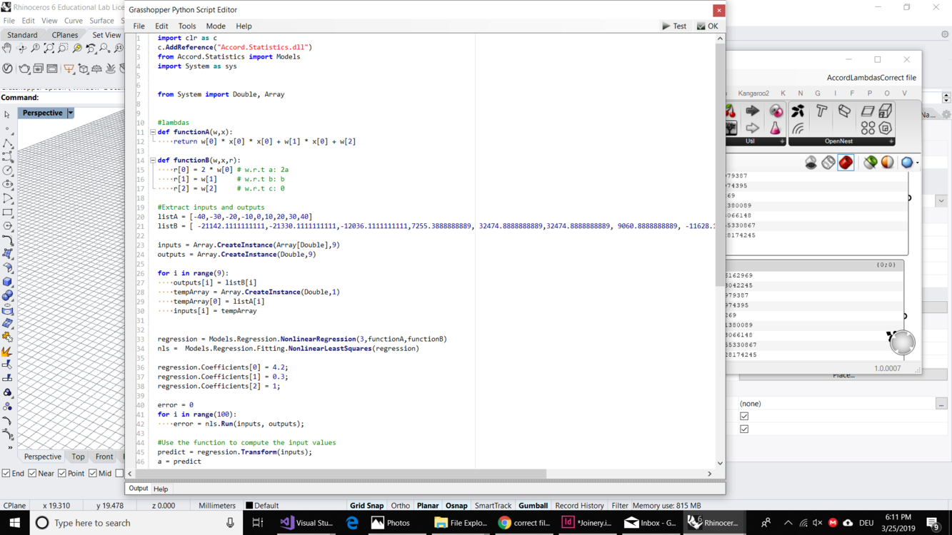

> Download Accord. Net library that runs on both C# and python
Can you explain how to use it within a python component?
<div class="post-metadata">
**Author:** ![Petras\_Vestartas](https://sea3.discourse-cdn.com/mcneel/user_avatar/discourse.mcneel.com/petras_vestartas/32/480531_2.png) [@Petras\_Vestartas](https://discourse.mcneel.com/u/Petras_Vestartas)\
**Post date:** [March 25, 2019, 4:12pm UTC](https://discourse.mcneel.com/t/k-means-clustering/74903/10 "2019-03-25T16:12:41Z")
</div>
Rewrite this in python you will need System.Collections because you cannot use python lists.
> **[Clustering · accord-net/framework Wiki](https://github.com/accord-net/framework/wiki/Clustering)**
> Machine learning, computer vision, statistics and general scientific computing for .NET - Clustering · accord-net/framework Wiki
This is another example from [Accord.Net](http://Accord.Net) library that I did while working at CITA, try re-read it and adapt it to KMeans clustering, the logic is similar, but the array is a bit confusing. This gives you a grasp how to import .NET libraries:
 ![image](https://global.discourse-cdn.com/mcneel/uploads/default/original/3X/8/7/8743de97ae5191a4ce9cec8b01681edc18133f22.png)
