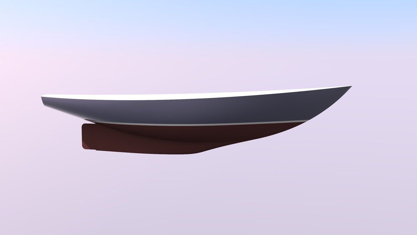

Accomplished this in Rhino as well, see attached. Job was to recreate a Bermuda Forty from a poorly scanned set of ancient hand drawn hull lines. Tweaked the form such that the displacement and other hydrostatics matched the original within .5%
That keel looks too fat! Maybe foreshortened in that bow view but I know that hull shape well from scrubbing the bottom. How about an ortho body plan view or I’ll have nightmares?
All I can tell you is that I used a scanned digital version of the original hull lines done by Bill Tripp senior. And that the boat is a keel/centerboarder that originally had (I believe) a wooden centerboard that was likely fairly thick for strength purposes, thus the keel is a bit thick but likely over the entire length of a typical keel chord, the sectional foil would only be 10% or even less. I did this at the request of the owner who wanted a couple of hydrostatics and stability runs for his particular boat that was getting a new deck.
