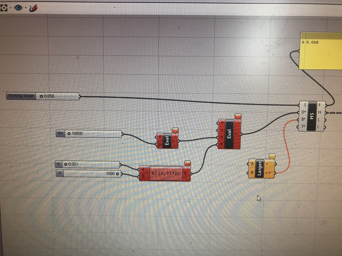

(McEnz) #5
yes i know lambda is on both sides. It’s the prandt colebrook equation and has to be solved with an iteration. next time i try to use latex and thanks for the help.
i try a lot but i can not find a solution. The Variables Re, k and d are known.
This is what i try but i always get an expression generated an error for…
(qythium) #6
You have to use a period for the decimal separator: k/(3.71*D)
Upload the gh file if it’s still not working.
