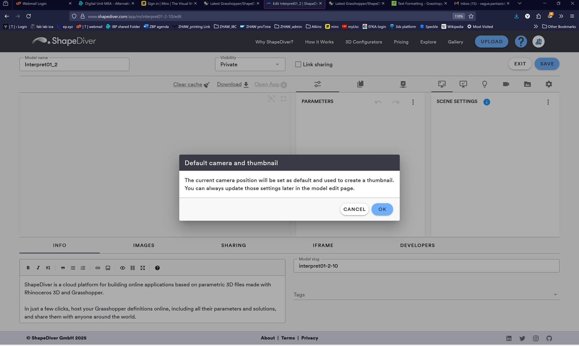

Dear Community, I have been trying to upload a script on the shape diver platform for a couple of days but after passing the check, the 3d viewer is blank and when I hit ok on the pop up window it does not work. Does anybody has faced similar issues? Is there maybe a temp problem with the platform ? I am using R8 and accessing it via Mozilla Firefox

It seems your model is not defining output geometry, and also no parameters (the screenshot doesn’t show any). Please check out the tutorial center for some examples. You could also share your model here.
Here is model, it has both parameters and outputs but for some reason they were not coming up. It worked last week when I tried it

Many thanks! I tried uploading your model, and it works for me:
Does the platform show any error messages when opening the edit page?
