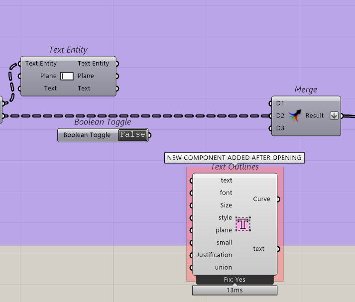

I’ve been having an issue recently with Text Outlines component: it seems the Fix parameter has become mandatory, but is wrongly typed (see screenshots attached) making it virtually unusable.
To fix this, i’ve been using the other Text Outlines instead that works fine but my old scripts that use the previous components broke.
Is there a way to make the Fix input non mandatory again / adapt the input type ?
Thanks!

Sorry to undig this thread but i have a new issue. My flexibility Text Outlines
components seem to have broken again with the new Rhino update. When i try and open the files, i get this issue:
When i Close this window, my script opens but the Text Outlines
components have disappeared.
I tried to update both Rhino and Flexibility to the last version but it doesn’t solve the issue.
Nota: maybe it has something to do with Fix
. If i remember well, Fix
was previously dealt with as a parameter. What do you think?
Edit: i tried to replace components with the new ones. It works fine with the GUI but causes compute to crash:
Is there something wrong?
Thanks in advance!

Hello, because the fix modification is removed from the component entry and added (right click on the component menu)
For your problem in the next update I will add the previous component to the delay (legacy)component)

Thanks! Any idea with the Object reference not set to an instance of an object.: component "Text Outlines"
issue in compute?

hi this error fixed in Flexibility22.7.6
please test Agains

Hi this worked! Thanks a lot @arcarc60 !
