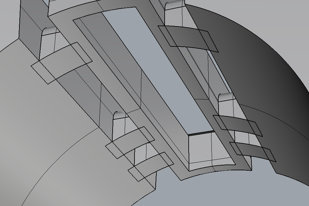

I made this model. After BooleanUnion it looks like this.
When I try to do FilletEdge, as more or less expected, because of these areas
the result looks like this. The resulting model has 12 holes in it.
I have had similar issues in the past with this small model.
In that case, after performing MergeAllFaces that took care of it.
I have tried MergeAllFaces on the new model, but that does not seem to work. What do I need to do to make FilletEdge work with my current model?

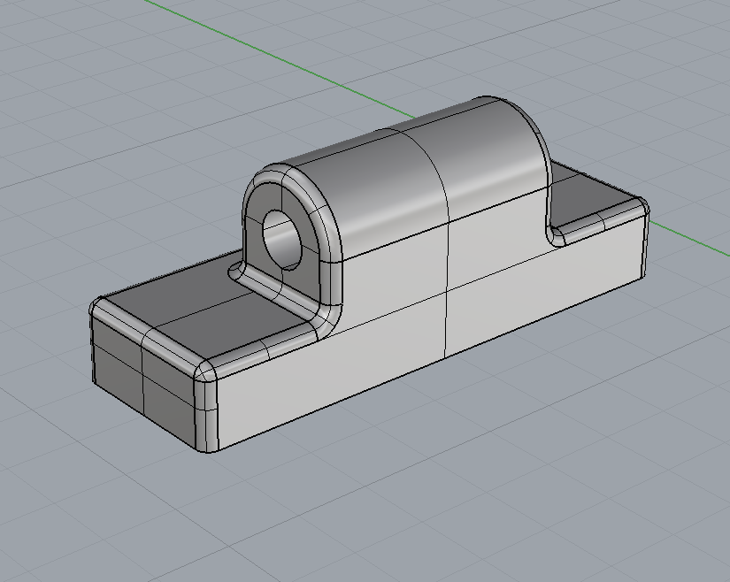

Unfortunately this does not help since the model you created is not my model. I have no issue making the model you created and add fillets.

I found a solution. It’s kind of a work around but I think it works fine. Here it is. Maybe others with similar issues can benefit.
I created a cylinder with a diameter .001 mm larger than the inside diameter of the ring.
Then I did a Boolean difference.
The result can now easily be filleted all around.
