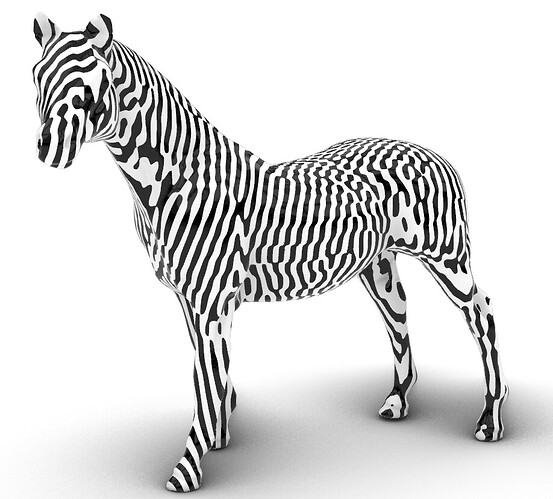

Thanks @DanielPiker , always cool to discover a new thing, as I still use a lot R7 and I love meshes tools, I reuse your Spinodoid concept in a tools that evaluate the field on a Point Cloud (a mesh in R7 as no Point Cloud there). I think it could be a nice alternative to reaction diffusion as it is a field so it is more easy to get high resolution and generate texture.

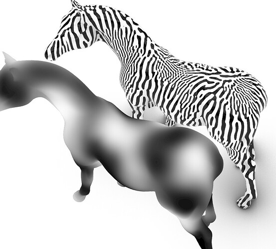

Varying the radius of effect

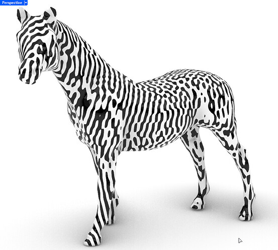

Piloting WaveLength with noise

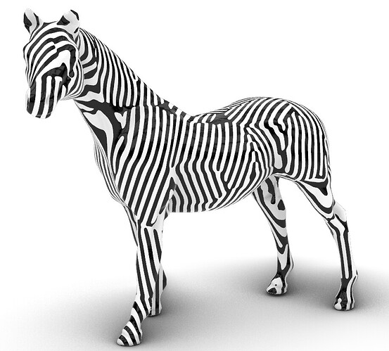

adding some rotation to plane

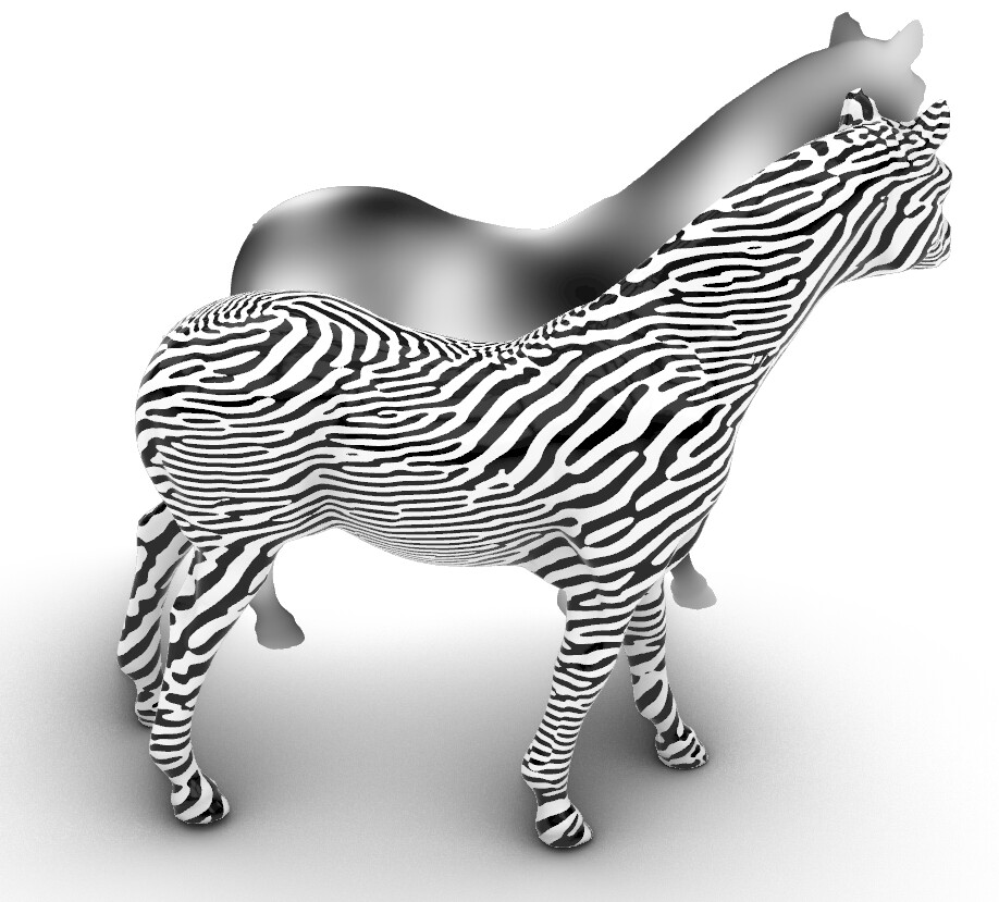

And for those who wonders, this is a continuous weight, but I use Mesh Iso Splitting
One drawback at the moment for Isopod if the time of calculation for the component ValueAt 1.4 min for 290 000 points vs 3.1. But I optimize a bit my tool by using Mesh (PointCloud must be better also), and I used some tool a bit better than Rtree also (I use Dictionary).
