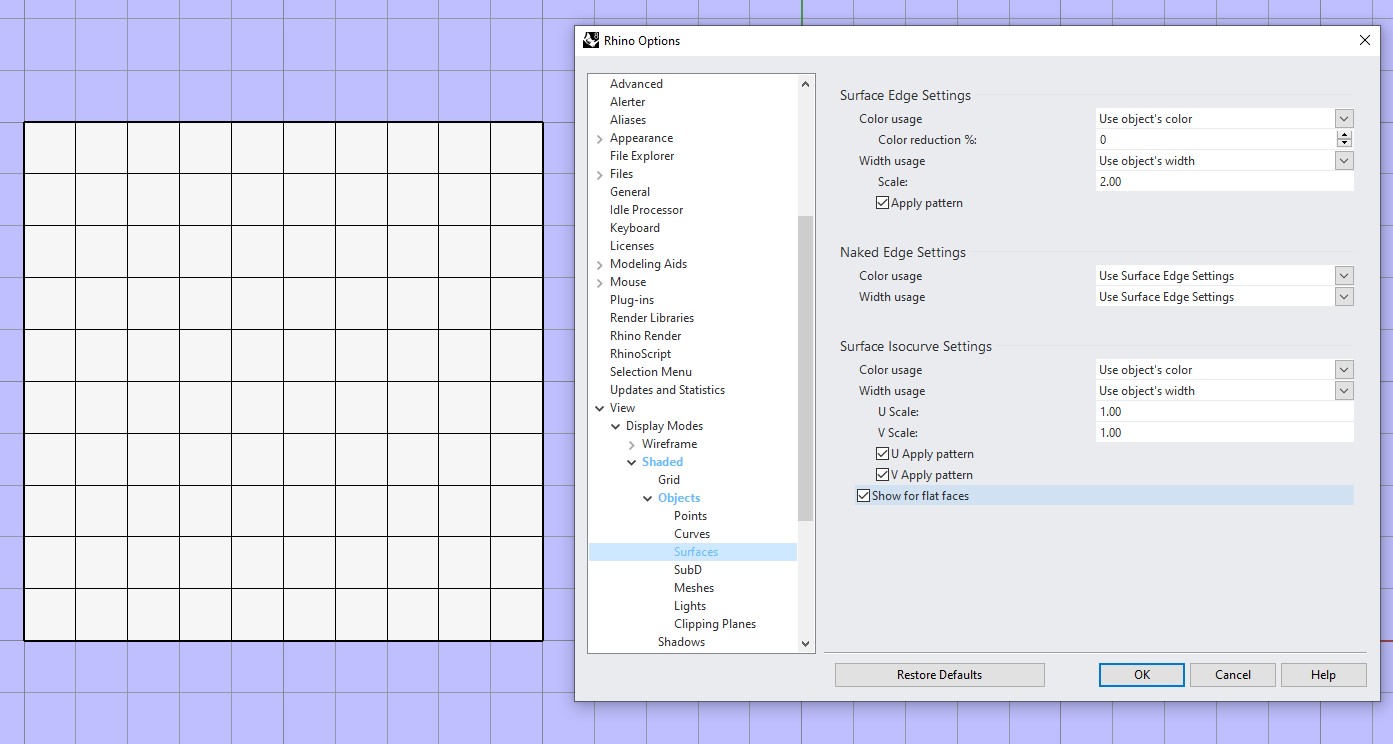

Is there a way to view isocurves for a planar srf in shaded view? Pic shows comparison between planar and non-planar (orange) srf.

Hi Hayden -
Yes. In the display mode options, make sure to check the “Show for flat faces” setting for surfaces.
