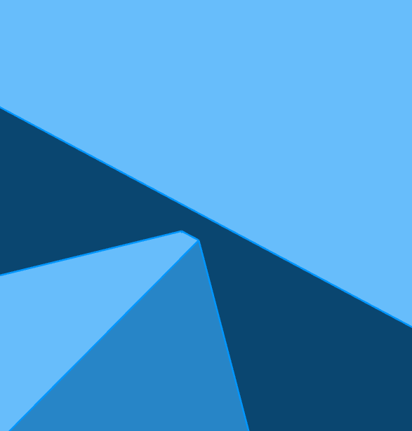

SR4 calibration sheet 3D NOnonManif chamfSrf MoveFce all elements JOINED together.zip (3.6 MB)
Steve
@Steve1 The surface selected below is “bad”. I found it by exploding your object, then using SelBadObjects. I don’t know why it is bad.
Hi, I just took this into v8 and when selecting the top surface it selected the rear one, it saw right through it,

From what I could see, the boundaries were self intersecting.
Attached is a repaired object
SR4 calibration sheet repaired.zip (2.1 MB)

It’s not just you, these things can get tricky, esp. if you are doing a lot of modifications that are very tiny in relation to the modeling tolerance.
ExtractBadSrf selects the surface you pointed out as the bad one.
I then first tried UntrimAll with Keep Trim Objects, but that did not seem to work.
Next I used DupBorder on the surface and deleted the bad surface. When I tried to make a PlanarSrf out of the result, it showed me a warning of self intersecting curves. Proceeding was a bad idea, or I was too impatient, or both, so I killed Rhino and restarted and repeated up to the DupBorder part.
I then created a planar surface with just the outer curve, and Split the result with the remaining curves. Then joined everything back together.
To visually show the issue, after Dupborder you could run SelSelfintersectingCrv:

Zooming in at the area you show, the bar touches at its pointed tip the block with the female troughs in it.
is that where the non manifold is, looks a likely candidate, BUT RHINO 8 DECLARES IT OK.

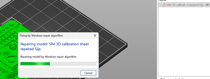

I already advised you what to do in another thread, namely to open it in PrusaSlicer and fix it there. btw, the fix is not really necessary, as the slicer has no issues processing it. In case you do want to fix it, it is really simple to do:
When opening the project in prusaslicer you’ll see:
notice the exclamation triangle next to the filename.
Right click that triangle and it starts repairing:
After that:
Done

It might be, but that still doesn’t mean you don’t need to verify your work. Therefore, my recommendation is to use step and load it in PrusaSlicer, check and repair there, and from there make the .3mf file.
name me one tool that can do it all. Rhino is not a 3d printing app. The app I linked to is open source, and free, and solves your issue.

I don’t know what Anycubic does with step files, maybe their meshing algorithm cannot deal with the file.
I advise you to simply follow the steps I suggested, doing the conversion yourself in Prusaslicer, so that you know the print file is correct. Export an stl from there, or the .3mf file, or both.
If you then import the stl back to Rhino and no errors are found, it should give you some confidence the file is ready to go.
