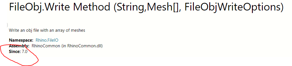

I have a Mesh[ ] object that I want to save as an obj file, as shown in the API FileObj.Write Method (String, Mesh[], FileObjWriteOptions)
However in the python docs I can’t find this. There is one FileObj → Write option, which is a different writer FileObj.Write Method (StreamWriter, RhinoDoc, FileObjWriteOptions)
I don’t want to save the entire doc. Am I missing something obvious?

Hi @umcadop,
The API I referenced is for Rhino 7. What version of Rhino do you have?
– Dale
Ah, Rhino 6. So that overload was added in 7?
Well, sorry about that. Time to upgrade I guess.
