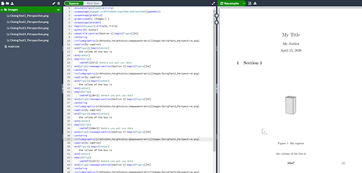

This is what I intended… Just to provide the proof of concept.
I used “overleaf” to work on Latex so some functionality won’t work on others… but it kind of works?
Logic is simple… format things into Latex grammar on Grasshopper and just copy paste the final texts to the “overleaf” blank sheet and compile.
More sophisticated formatting would require some time… but I managed to do this by just googling stuffs I needed. Maybe more skilled Latex user in the forum might help.
I used Ladybug’s Capture View but I think it would be attached to the file since its written in ghpython.
Anemone is also used for looping, but this is not crucial in workflow.
(*May use animate in slider)
GH_Latex.gh (393.2 KB)
GH_Latex.pdf (64.7 KB)
