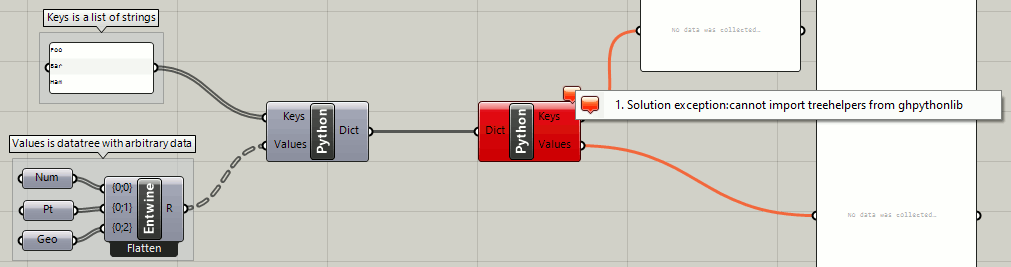

Maybe Python dictionaries are a better match. I use these a lot for structuring/interfacing/writing/reading data (as they are very simple and map onto to e.g. JSON natively with the json module) . Here’s a quick example:
191012_GHPython_Dicts_00.gh (13.2 KB)
Error in R5:
  1. Solution exception:cannot import treehelpers from ghpythonlib
Yes.
Thanks! Will try it asap!
:man_facepalming:
Here you Joseph, just for you. I think this might even work in V4:
191012_GHPython_Dicts_V5_Approved_00.gh (23.8 KB)
