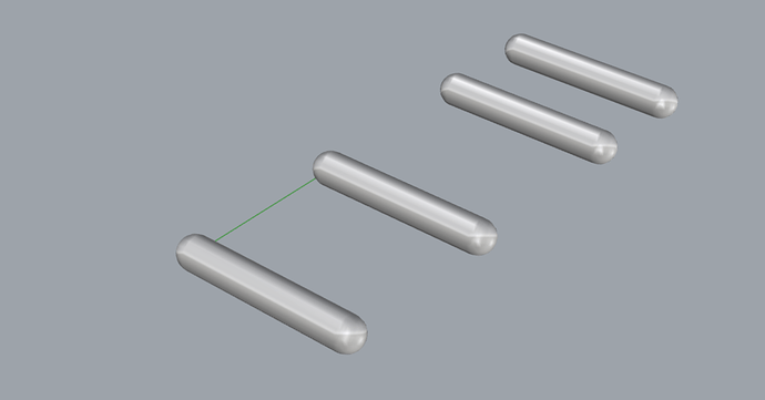

ok, so I was able to select the object and inspect…
I wish the bounding box had some sort of more interaction. I’d like to be able to adjust the orientation of the bounding box relative to the object of interest being measured.
Your best bet is to install the latest WIP build from Testflight and use the DimAligned command.
Automatically finding the tightest bounding box around an object is not in the scope of iRhino.
I think that problem is best solved with a custom script or gh definition which potentially can be solved remotely on a compute server from the App.
You have an Appstore build installed, you need to install a build from Testflight to have the WIP features like commandline
