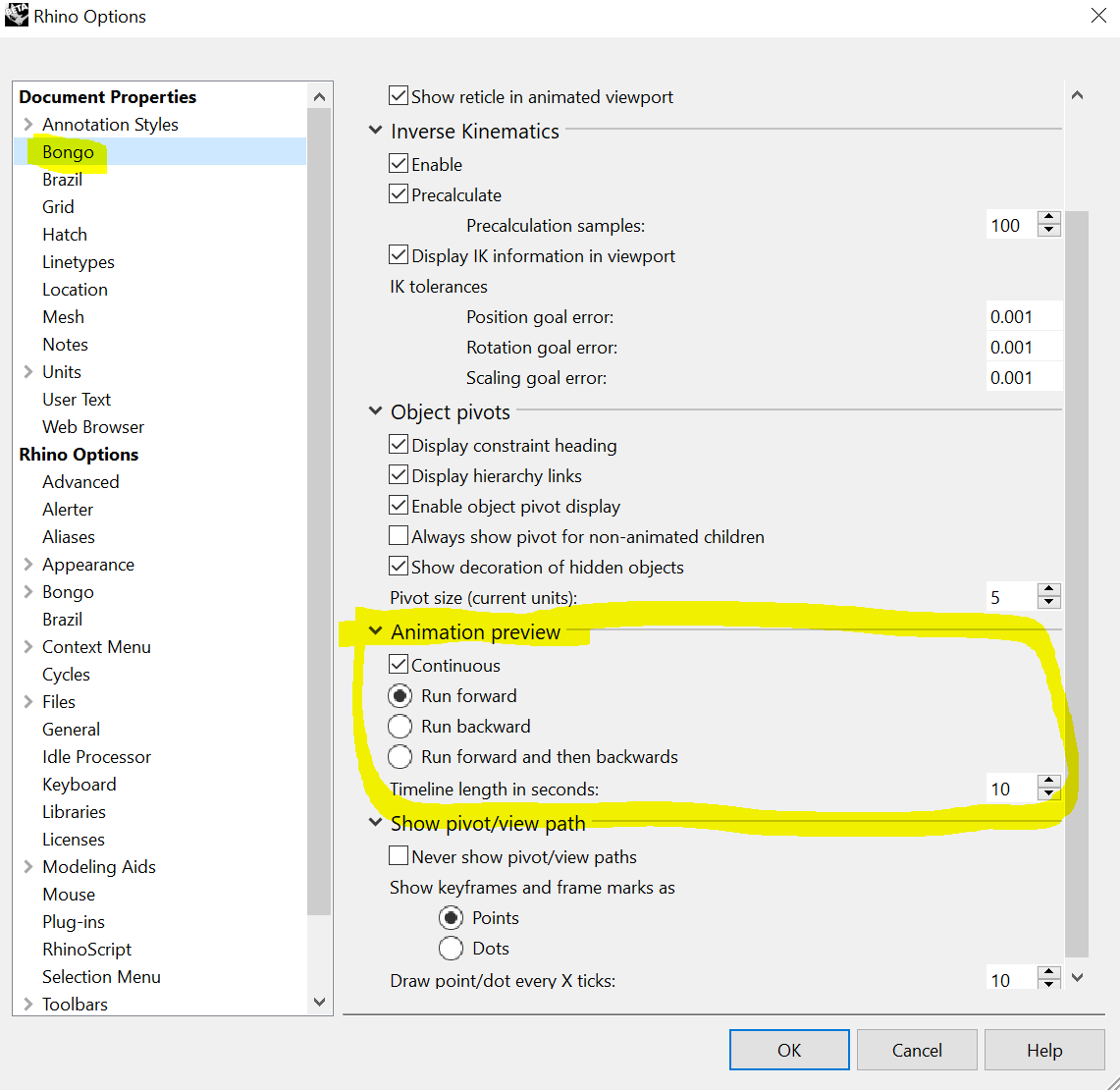

In the Bongo Properties, you can specify how you want Bongo to play the animation: backwards, forwards, or forward and then backwards .
If you already have rendered the frames or have the video, then you need an encoder that can do that, the Bongo Video Encoder can unfortunately only build the videos from frames in numerical order.
