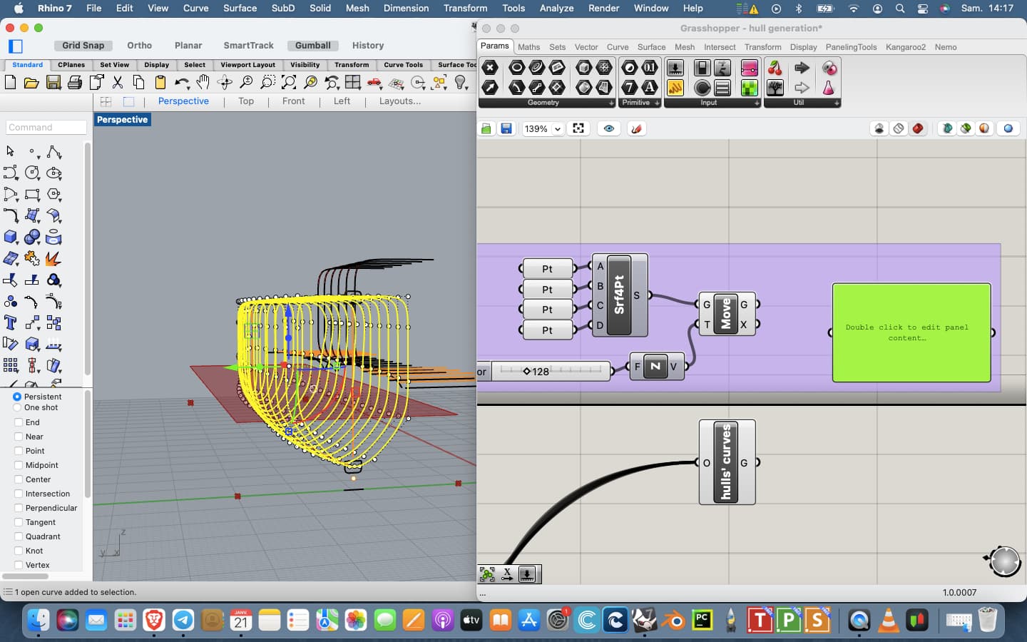

I would like to get the intersection points between the red plane and all the curves that form a hull and then create a surface out of it.

Ok got my intersection points.
Now I would like to create a surface with this points.
Don’t know if I can use sfrGrid with this list.
I could draw a curve between points according to their Y position and then loft those lines.
Any idea?

What we’re talking about is on top of the sheet. Got my points, but struggling to create a surface with them. the initial curves are made in Rhino.

You weren’t far with the lines, just needed to flatten and add a Loft.
Also it’s possible to extract the points in order and build a polyline, from there fill the curve.
