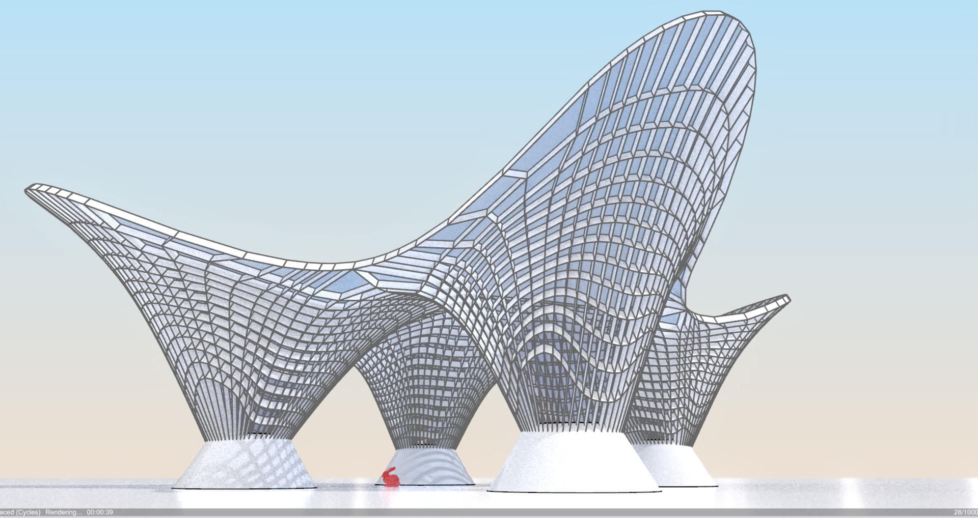

Cycle rendering. It started working!
Really!? Is this some form of joke?
:smiley:
Can you show us a render using OneAPI? If so, does this just mean OneAPI, or is Embree there too?
Is this WIP 9?

FYI, this is Rhino8, not WIP.
Awsome!
@DavidEranen Has something changed in the OneAPI approach that fixed the rendering? Or perhaps this is due to a change in the exposure of the Intel GPU. This is interesting as well, as this is just the ā€œonboardā€ GPU on the CPU tile. I’d be interested to see if anyone with an Alchemist (A750+) or Battlemage (B570+) can see OneAPI.
If this is accidental, it may be a happy accident for many mobile users.
@David53 Yes, we fixed an issue that was stopping OneAPI from working.
