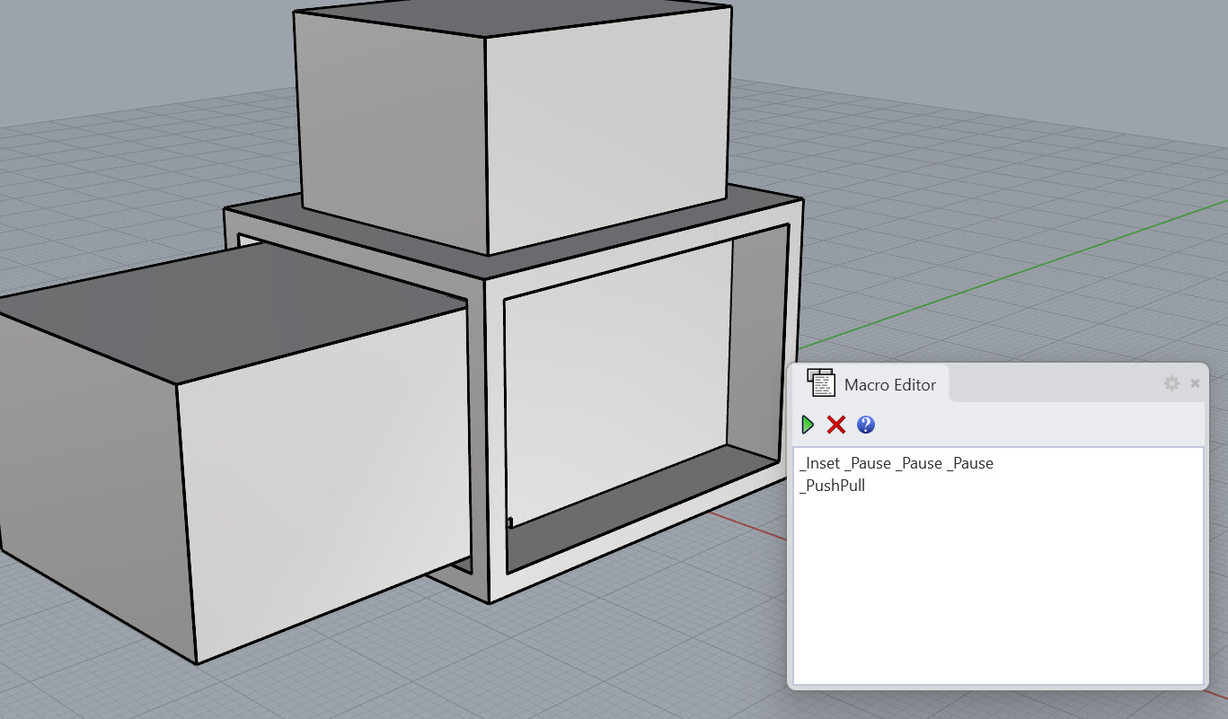

I’m trying to create a Macro or Script team up Inset & Push/Pull so that after I inset, the push/pull seamlessly takes over, awaiting which faces I’d like to adjust.
Anybody have this already, or have a moment to help?

Hi Alan,
try this macro
_Inset _Pause _Pause _Pause
_PushPull
This is very basic… don’t know if can solve your needs…
Haha, thanks, Lucio. Guess I just needed to put in one more “_Pause”
