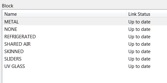

This is after running the macro once
1
And this is after running it twice
2
