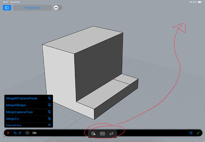

Incredibly exciting potential with the iPad app! Thoughts and suggestions
Yes, I did find that one.
Thanks!
One more wish, if I may :wink: :
  • a properties panel (like in desktop Rhino)
