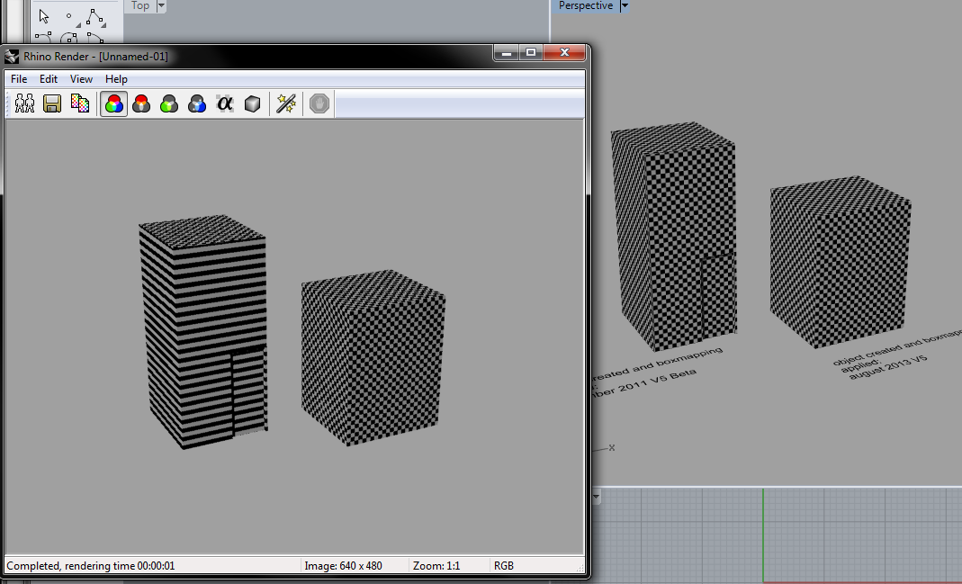

I had to revisit a project from back in nov. 2011.
The applied mappings are incorrectly rendered in todays RhinoRenderer
The viewport however does show the correct mapping.

Hi Willem- right now I’d say both… but I’ll put it on the bug pile in case there is something the developers can do. I do not, at the moment, see a convenient way to deal with this - just reapplying box mapping.
Hi Willem,
@andy will have to say for sure about the old mapping support with RR but I don’t find a work around other than using Neon/RR or Brazil both of which will give you what you see in the rendered view.
