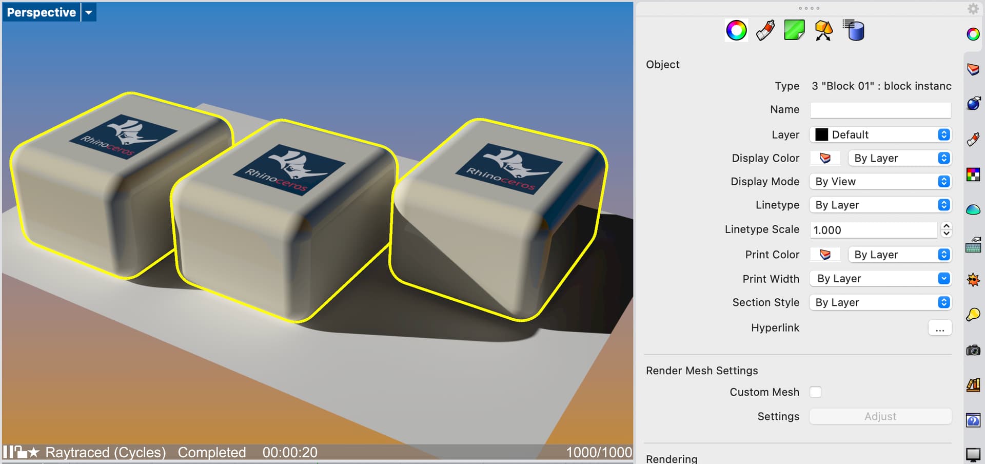

Similarly, we note that decals are not functional within blocks. What I’d like is to create a light fixture with a decal. But alas, no.
Programmatically, what I imagined was that blocks are simply selective viewports to items. This would make everything available to any block, each item need not be contained exclusively within a specific block, and each item would retain all of its potential properties and accoutrements.
My context is custom boat building. The money is in luxury boats that people mostly just look at and rarely use. If everything is luxurious eye candy, then money is no object. Like Nike swooshes everywhere. I personally think this is silly, but I’m not the guy spending the money.
Not sure what you mean, decals work fine here. Here a box in a block instance. The box has been decalled before it got put into a block. The block instance is copied three times.
decals_in_blockinstances.3dm (313.7 KB)
I tried to reproduce, and it may be that the problem is not related to blocks, but instead resulted from general decal wonkiness. Possibly I decalled the object with only a render viewport open (no Raytrace), and regardless of whether the object went inside a block, the decal would not have appeared when Raytraced.
Generally, some messing with materials separate from decals gets the decal to appear when Raytraced. Very repeatable is (1) decal not appearing, (2) change the material to something else, (3) turn the decal OFF. The decal appears (when its check-box is unchecked). Then turn the decal back on and it remains.
Decals disappearing while in Raytraced and changing material settings is a know issue: RH-63193 Material updates on objects with decal in Raytraced fails
Note that this is a separate issue from lights in block definitions though.
