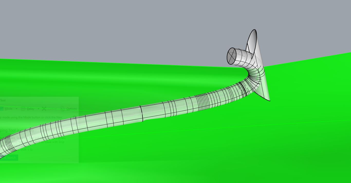

here you have some examples:
<div class="post-metadata">
**Author:** ![gileshg](https://sea3.discourse-cdn.com/mcneel/user_avatar/discourse.mcneel.com/gileshg/32/474970_2.png) [@gileshg](https://discourse.mcneel.com/u/gileshg)\
**Post date:** [October 5, 2019, 5:27pm UTC](https://discourse.mcneel.com/t/improving-filet-edge/89875/16 "2019-10-05T17:27:41Z")
</div>
you make it look so easy. I get some crazy errors. this one looks nice 🙂
 ![5](https://global.discourse-cdn.com/mcneel/uploads/default/original/3X/e/9/e9556995c76ce91ee31e173a96b0bb2b00a6207e.jpeg)
**Author:** ![DiegoKrause](https://sea3.discourse-cdn.com/mcneel/user_avatar/discourse.mcneel.com/diegokrause/32/257432_2.png) [@DiegoKrause](https://discourse.mcneel.com/u/DiegoKrause)\
**Post date:** [October 5, 2019, 8:17pm UTC](https://discourse.mcneel.com/t/improving-filet-edge/89875/17 "2019-10-05T20:17:45Z")
</div>
use RebuildCrvNonUniform to have a smooth curve, then pipe it
