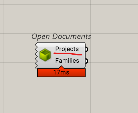

Alternatively, you can open multiple Revit files in the same project instance and access specific Revit files using the Open Documents node.
I’ve tried the Open Documents but it’s not able to detect other open revit files somehow.
Nonetheless, I’ll try the Create Method you suggested above.
Thank you very much~
