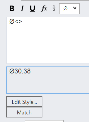

Hi! How can I made this diameter dimension style?
And this radius dimension style.
Thank’s.
the only way (I think) is to use a regular linear dim and manually place a diameter sign in front of your dimension.
Rhino 7 Windows…
DRAFTING TOOL TAB…
RADIUS DIMENSION CMD.
